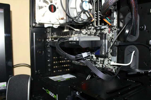

Okay no problem, if you look in my build log in sig there should be pictures of the card. It's not a blower, it dumps it's air into the case. Here are the fans, also have 2 SP120 quiet editions pwm.http://www.enermax.co.uk/cluster/

That's the CPU cooler & GPU

Well then,
Bottom Front - is pointless due to HDD cages stopping most of the air.
Way #1
Top Front -Intake - Around 80% speed (whatever noise is comfortable really)
Left Bottom - Intake - Around 80% (requires removal of second HDD cage though)
Exhaust
Back Fan Running MAX of 50% of its speed.
or you can take it out all together, your CPU will most likely be cooler with it in though.
not many much options with both HDD cages :(
do you need both?
Sorry, should have made it clearer. One of the HDD cages is already out, the one furthest from the front (that picture is a bit dated) :) In it's place in the bottom is 1x Enermax fan
I need one though, yes
ok so,
2 quiet (corsair) front fans running at 60%+ (decide yourself on noise that suits you) ofc you can PWM these depending on usage
1 back fan running Max at 50% (emermax)
this will be best. :)
So I will have 3 fans spare? :D
and the two front fans on the front panel or one in the bottom?
both on front. as you have the 1 spare gap between that and hdd cage, shouldnt matter alternatively you could put hdd cage closet to the bottom front7 fan and moving front bottom fan to position 2 of the bottom, its trial & error depending on room arrangement :)
also i would suggest taking the top dust filter off, this way as heat rises it goes right out the case rather than trying get through the small dust filter gaps :) (you could try with it on & off)
thiis method is positive air pressure so any hot air wil;l be forced out by nature of design of the fan arrangement. so hot air will be forced out of the top of case :)
