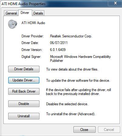

ok just tried to connect my hdmi on the card to me 42" plasma and ive installed the realtek ati 2.67 drivers and i get no sound through to the tv. Now ive tyried various hdmin leads so not that, and when i look into playback devices the ati hdmi audio says not plugged in ? any ideas what i can do to solve this?
checked which driver its using and although ive installed the latest its only using this driver -
tried to update etc but says its using the latest driver when its clearly not?

It should not say REALTEK so something in the ati installation has gone wrong. Try re-installing from the correct drivers and just select hdmi audio drivers
Or try and right click and press "show disabled devices" - does ATI come up?
it says realtek if you install the realtek drivers. it says AMD if you install the.....wait for it.....AMD drivers:p
