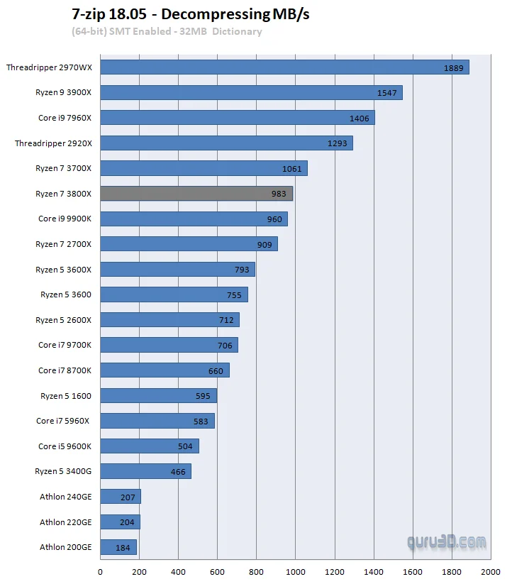

Could anyone help me to understand the following image... (posted on Guru3d review for 3800x)
The reason why I am confused is that I found information that suggested 7zip can only use up to 8 threads when decompressing*. I am guessing that this information is incorrect if the 3900x (12c/24t) can be so far ahead of the 3700x(8c/16t) in these benchmarks? Also quite confused as to how the 3800x ended up below the 3700x haha.
I can't imagine that the 0.2GHZ of single core clock speed is the thing making this possible.
Does anyone know how many threads 7zip can actually use?
Image is showing decompressing, which will be different from compressing.
Either way, the amount of threads/cores it uses will entirely depend on what compression level and method 7zip is set to. By default 7zip will be using LZMA2 which itself only supports up to 8 threads when compressing.
Assume 3900x wrecks 3700/3800 cause it's got 50% less memory Write speed and it affects copy also.
It seems to load up all my 12 threads, and in the results panel its showing roughly 1100 to 1200% so i'm assuming that is thread utilisation.
To me that image looks like its scaling with thread count, all the way up to the 2970WX. (48)
