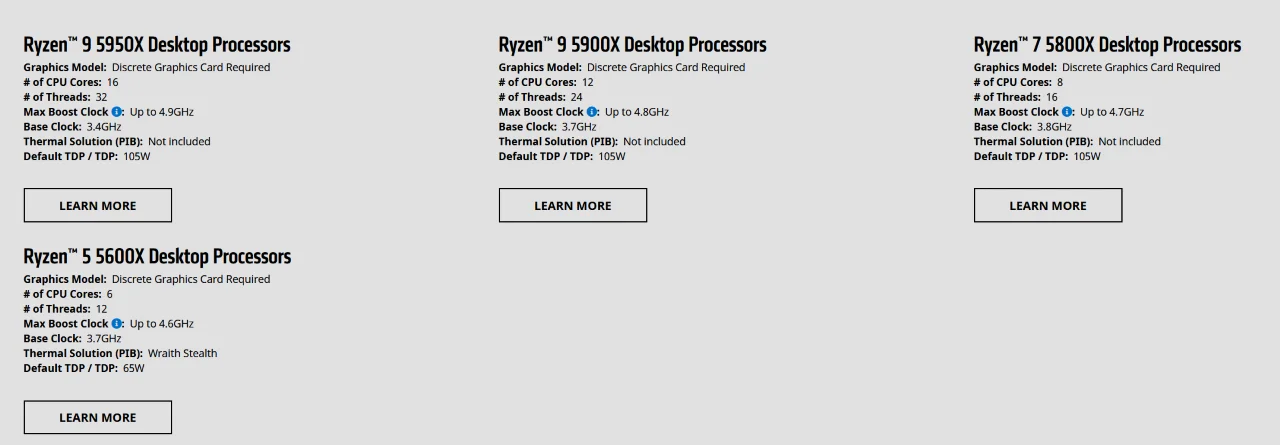

Look at the specifications. The Ryzen 7 5800X base clock is only 100MHZ higher than the Ryzen 9 5900X,but it has a worse boost clockspeed. The TDP is the same. So it tells me the 6 core chiplets used in the Ryzen 9 5900X is better quality than in the Ryzen 5 5600X and Ryzen 7 5800X(42.5W per 6 core chiplet).
