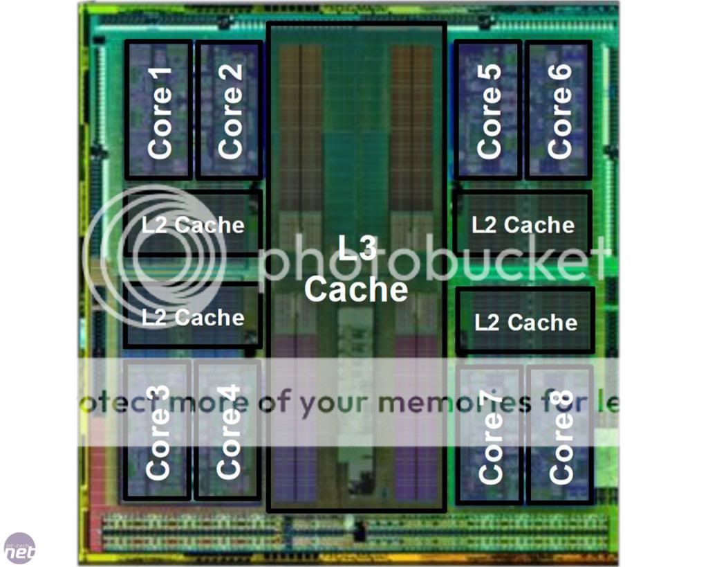

There a pretty complex chip, i did read an AMD PDF explaining the inner workings on the chip, not that i can find it right now....
It seems they have 8 Integer cores and 8 threads @ 128Bit or 4 threads @ 256Bit, depending on what is asked from it.
They have 4 Modules with 2 cores in each module, When the Threading is high enough either by application or multiple threads running on the OS from multiple apps you will get 8 threads @ 128Bit, if threading is low the 2 cores in each module with join up to form one big core and thread as one through a 256Bit pipe.

how does the piledriver not have true 8 cores?

An FX8350 has 8 integer cores,with a pair of cores sharing a FPU unit. The FPU can actually run two FP operations at once(a sort of SMT like arrangement),although each operation will run slower, but throughput would be higher.
