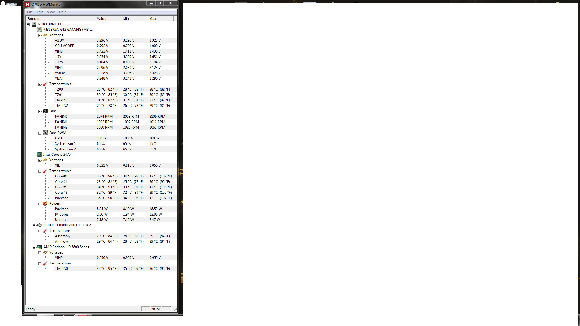

My other temps are all fine as far as i know,its just my GPU on certain games are real high like Alan Wake is 86C and BF3 around 84C now but then Day Z or Euro Sim 2 are around 67C-74C
I am going to play BF3 now,will post CPUID photo after a round of that
Before Battlefield 3
Just finished a game of Battlefield 3 -It's cool at the moment,probably the coolest its been all week
Everything ok? Yay or Nay?
