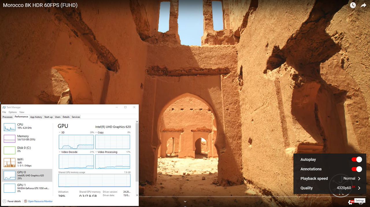

seems to play no problem on laptop gpu, UHD620 probably has some acceleration, I am assuming when it says 4320p60 it is actually decoding that, as I only have a 1080p screen it is hard to be sure.

Ah my last one wasn't 8k, it actually has to show the 8k badge, you have to force quality to 8k, you can see what it is running turning on stats for nerds, still the intel GPU is doing all the heavy lifting. 10 dropped frames were when I tabbed out to bring up task manager.
