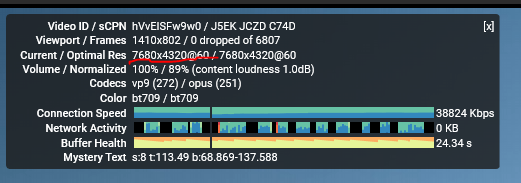

You don't need an 8k screen you just enable 8k and it will decode at that and then play at your res as shown in the stats bit, my res is 1410 x 802 as I have it in a windows but it is running at 8k as shown in the current but underlined below, if you leave youtube to its thing that current would match your res and be less taxing.

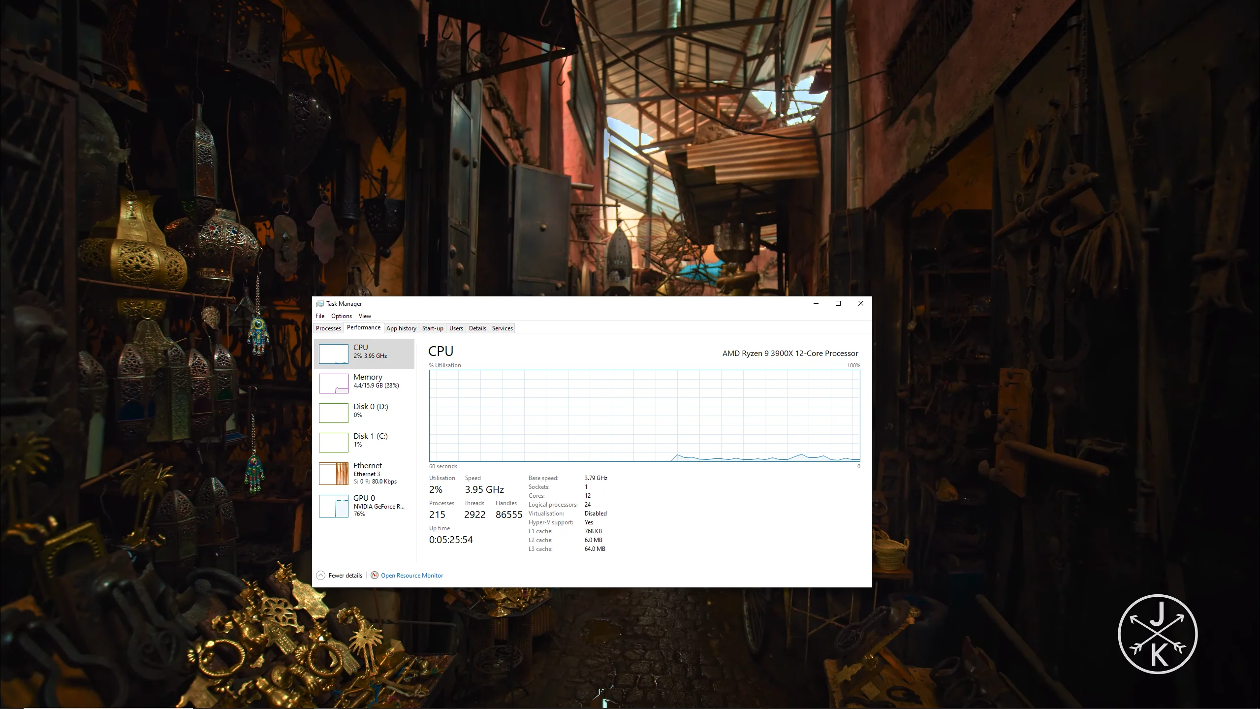

Dont know what's up with MyBrains rig, but my sig rig plays it flawlessly. CPU at 2% utilisation and GPU at 75%.
