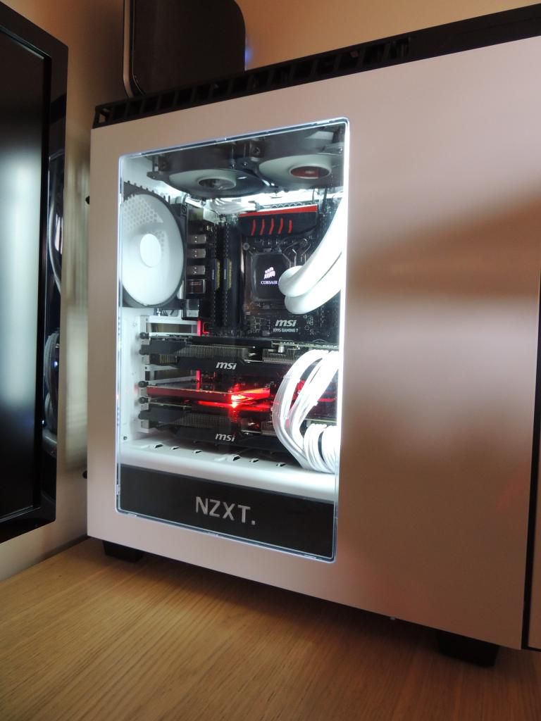

I have the same setup as you, H440 and MSI Gaming in Crossfire, which means you should have no problem getting the temps down on your cooler 970's.
It's not simple task to cool these cards, but here’s what I've done so far.
You have to use slots 1 and 3, I've tried everything to keep them cool in 1 and 2 but it just isnt possibly. I benched to find out the difference between X16 X16 and X8 X8 and strangely enough I get 1/2FPS more in X8 X8 config, so dont worry about dropping down from X16 X8.
Secondly you have to remove both SSD drives and drive bays, this
gives a small gap between the second card on the PSU metal cover.
Third, do as above and remove the metal mesh in the sides of the top and front cover.
Fourth get yourself some very good case fans which move a lot of air, I have 3 Artic SP120's on mine.
Fifth, get yourself a fan inside the case with also good static pressure to blow air between the cards on under the second card like so:
GPU-Z does show the GPU's the wrong way round, I'm still not sure why this is. With intense GPU games where 100% usage is used most of the time, you'll have no option to game with the front cover off. Pain in the arse, but I still love this case, looks the business.
