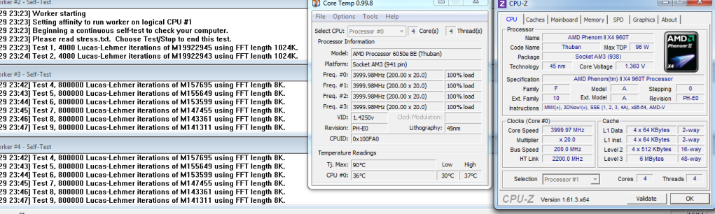

So my new fans are doing really well here is a screen shot of me under full load on prime95 and overclocked to 4ghz.

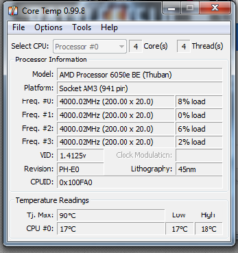

here is the temps when just doing normal browsing

loads of headroom left ! Once you hit low 50's then you'll start to see the threshold. What have you got your cpu-nb set to now?
