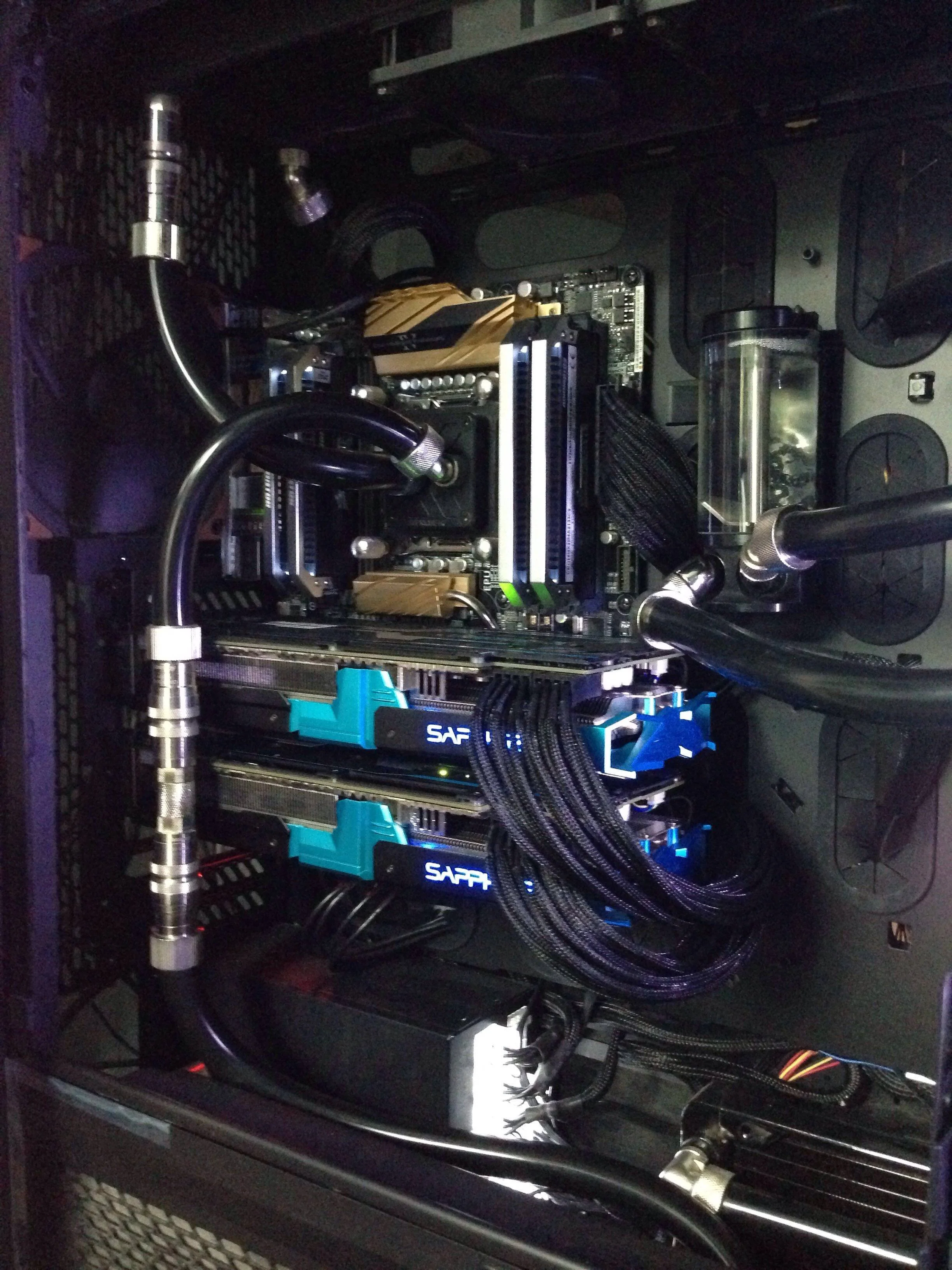

Or it proves people don't want them. I was given one by AMD!
4 left in the world and they couldn't clear them on clearance a few weeks ago. EK only recently released a block for the Vapor range, and the coolers are 3 slot. sapphire set themselves up to fail with this card frankly.
Also, they're binned but I can't imagine very high, as no Vapor-X that I've seen overclocks very well.
Good luck trying to fit 3 let alone 4
