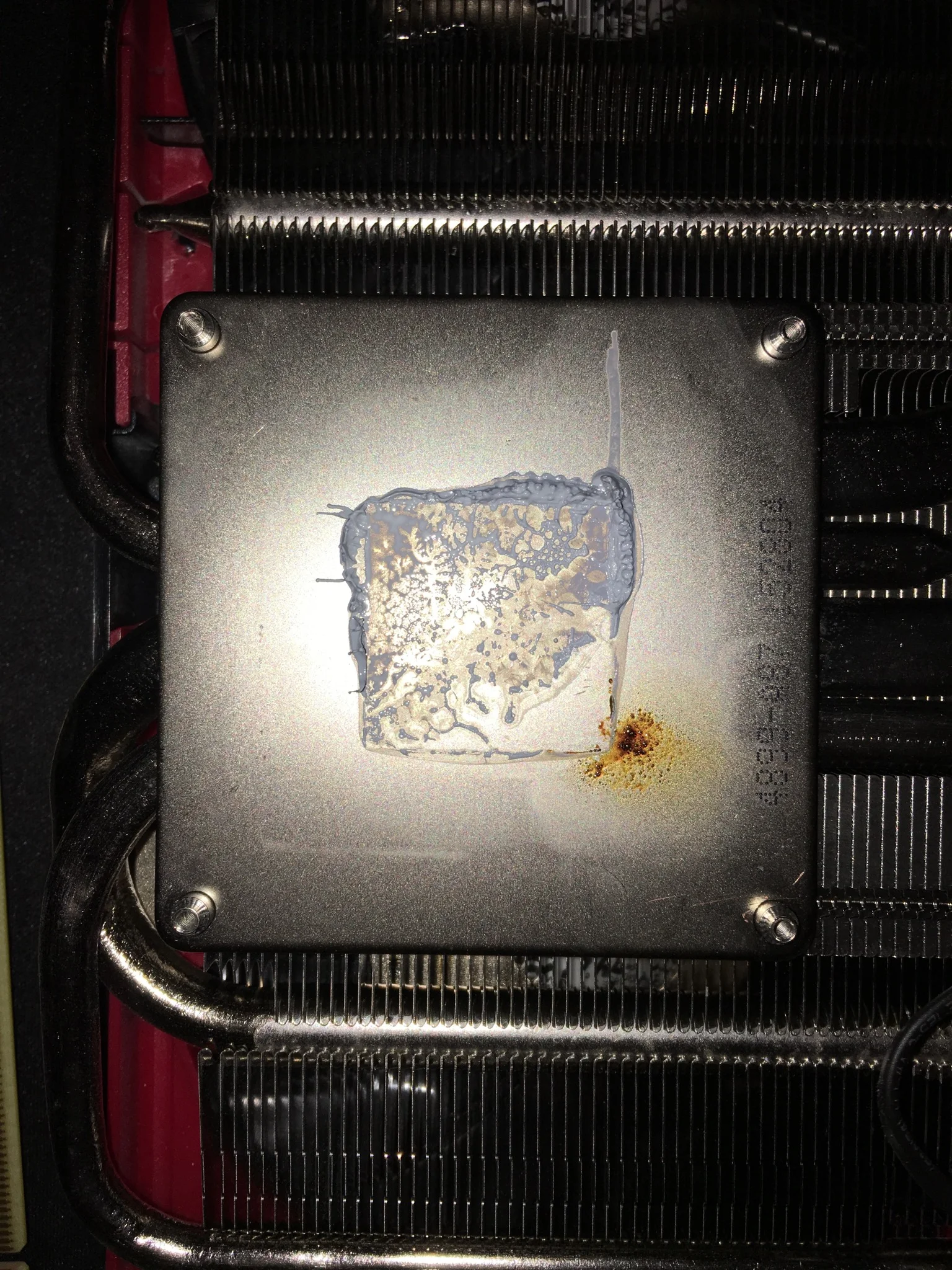

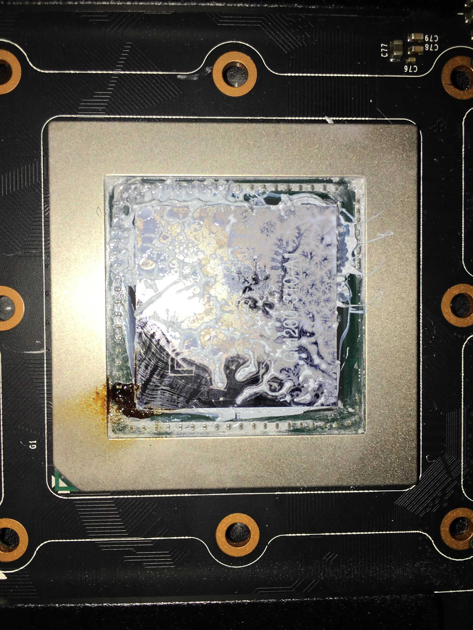

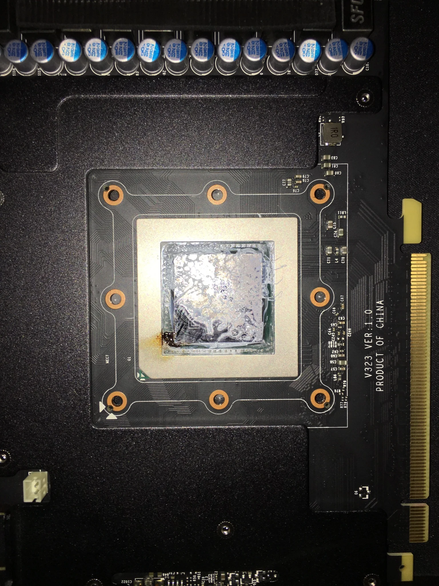

GPU Core
Underside of heatsink
Close up
RIP 980Ti. At bearly a year old you were to young to go out like this. :(
Any idea what might have caused this? i replaced the thermal paste about a month ago and the card has been running at 1500mhz since with the max voltage afterburner will allow running through it. It looks like there is no Tim on the corner of the GPU but I'm guessing that this was burned away when a jet of flame shot out of the core! It was definitely fully covered when I applied it. Could a dodgy Tim application cause this considering the card has been running stable with a pretty substantial overclock for a month? Temps have also been fine during this time.
Power surge maybe? My PSU is an OCZ ZX series 850w which I assume has surge protection built in? The card was running from two separate 8 pin cables.
The rest of my PC seems undamaged which is a bit of a relief! I could dig out my old 780ti to drop in for the time being but I'm a little reluctant as I'd rather not fry another card. Do you guys think it's safe to do so? My PC is booting into Windows fine without a GPU installed.
And finally, what's MSI's warranty like? I had to break a warranty sticker to remove the cooler so I guess I'm screwed there?

Wonder what component it was that popped, seems an odd place for something to go bang right on the bare edge of the core, usually it would be a capacitor or something on the pcb.
Smells like an insurance job to me.:p
I read that you are supposed to do a burn test when overclocking right!? :p
I think the core itself failed and the burn mark is where the flame shot out of the gpu wall in a jet. It certainly sounded that way. I was initially expecting it was a cap so it took me a little while to spot where the damage was as i wasn't looking at the core!

Doesn't look like the corner of the die was making much contact to me
Yeah its possible and it does kind of look that way. I swapped the tim for thermal grizzly kryonaut about a month ago and spread it over the entire core as per the instructions so its not like i put a blob on and it maybe didn't spread out all the way.

Wonder if something somehow made a connection over the SMD components there maybe a metal shaving from the previous application of paste or something.
