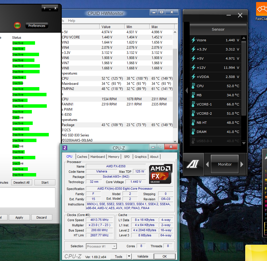

when i retested it; i kid not it shaved 20c off the load temps, its performing ~15c better than the old one.
it actually performs quite well, 65c under full load @ 4.6ghz, with the 412s i was getting over 75c at only 4.5ghz.
