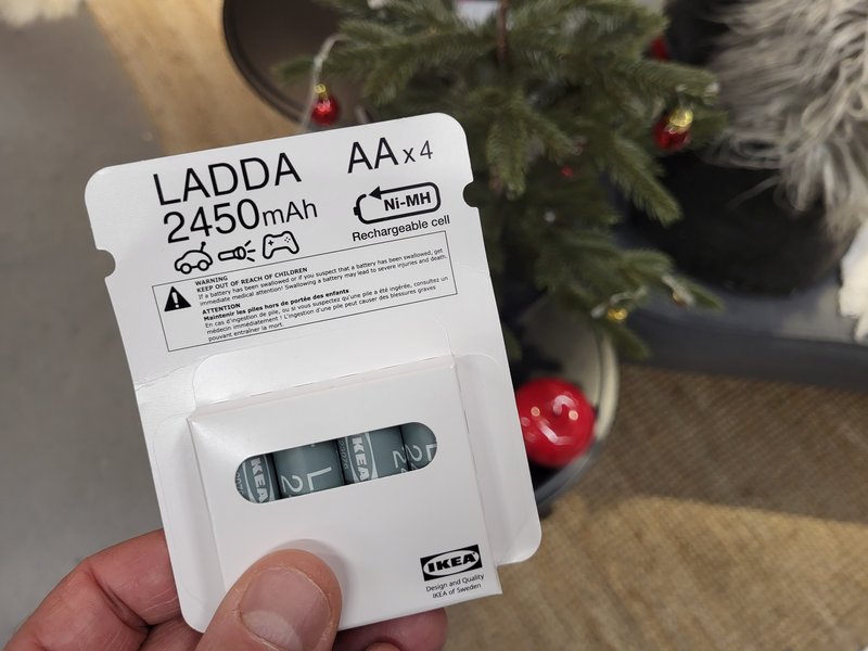

Right, I've decided I'll pop into IKEA and get a pack of Ladda AA 2450 mAh, £7 for 4.

Done. Only one pack left but tons of the 1900mAh. Got it just in time!
