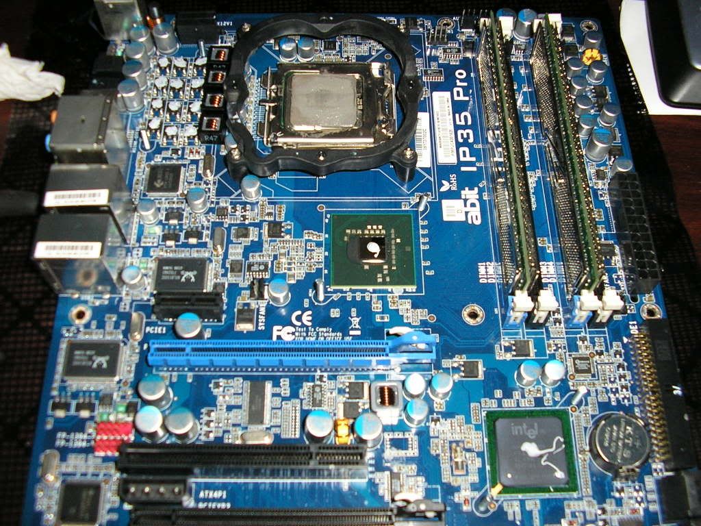

Here's a pick of my IP35 being bolt modded, you can see the thermal paste and bolts already in place, might give you an idea of how much to apply.
Thanks for posting the pic, so you wouldnt recommend spreading the paste once on the chips? On my CPU's i get a bit of clin-film over my finger and spread the paste over the CPU until its just a very thin layer
