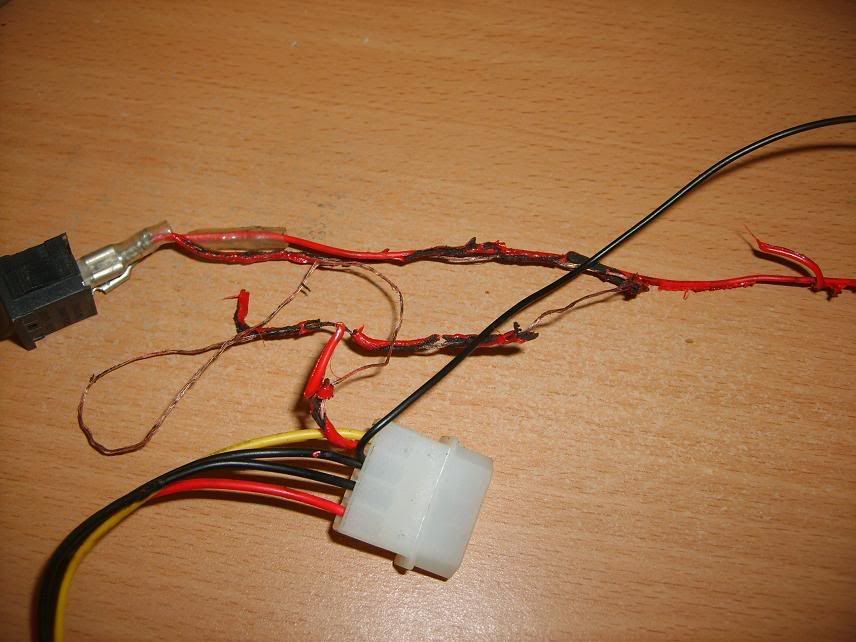

Funny that, I just tried some AC Ryan UV tubes out and got a puff of smoke from the inverter and now none working. I have had some Akasa UV running for over a year with no problems.

i think i know the solution to this issue.
It seams that cheaper cold cathodes do not like being connected via daisy chained molex connectors.
I.e. if you have like 5/6 adapters linked together with the cathodes at the end of the chain,they are more prone to this.
Best bet is if you have a spare molex coming straight out of your psu and just use them for your cathodes.
edit: oh and try to look for cathods with polarity protection such as akasa etc. It's the transformer that burns out, only saving grace is the fact that the plastic is there to protect other components in your pc. I.e. if one burns out, it will melt the plastic a bit and then stop working. They wont "set fire" to your pc, even if the transformer burns out.
