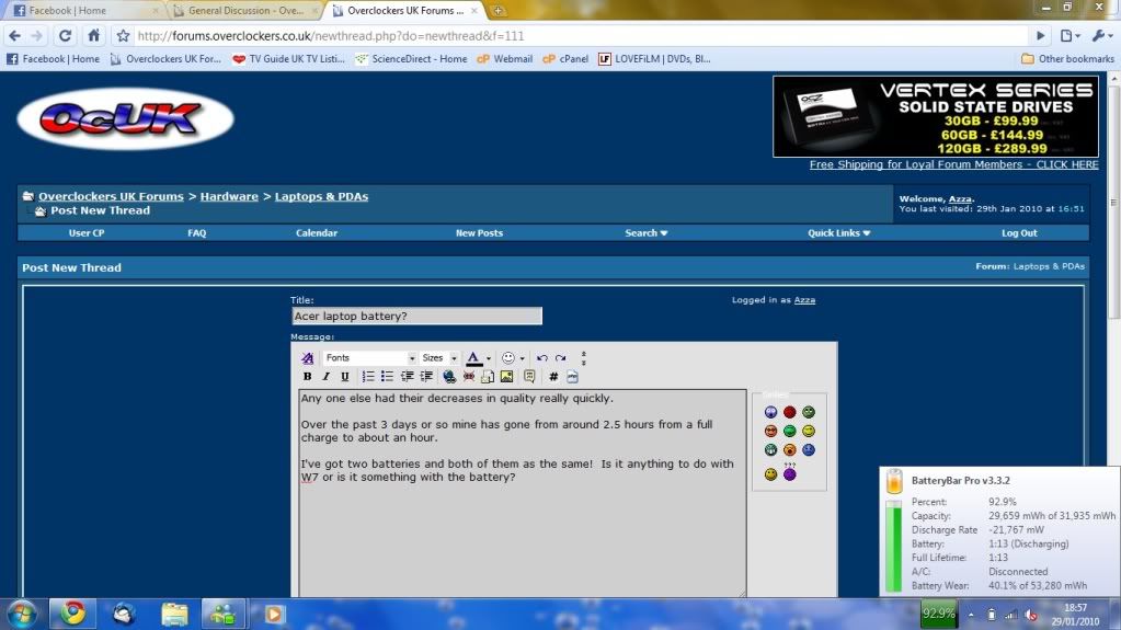

Any one else had their battery decrease in quality really quickly.
I've got a 6920 and over the past 3 days or so mine has gone from around 2.5 hours from a full charge to about an hour, and it seems to be getting worse and worse!
I've got two batteries and both of them as the same! Is it anything to do with W7 or is it something with the battery?
That battery wear doesn't look good. :confused: Think it's over a year old not sure.
I don't fancy shelling out £74 from Acer for a new battery, don't think it's still under warranty now, I'll have to find the receipt.
Anyone had similar problems?
