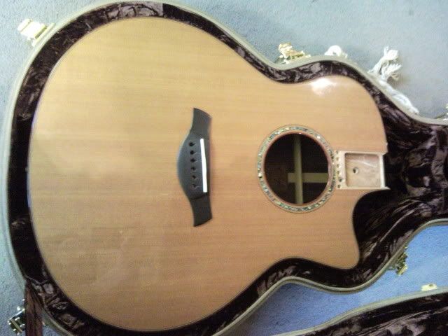

although one big problem my repairer has stipulated with taylors is the neck join to the body is a bit shallower than standard, and my neck cracked after only a year and half of playing. could be coincidence but its the second taylor this month she's worked on with a cracked neck! its in repairs as we speak

As for your Taylor's neck snapping, my Taylor snapped at the biscuit joint between the neck and headstock. I did have a pathetic amount of relief in the neck though, so I sort of expected it. Thankfully, Ivor (my luthier) tided it up an absolute treat and you can't see any damage. Maybe it is something to do with Taylors... My neck was machined as well, and adding a join at the headstock is ridiculous as it's the weakest part of the neck.
