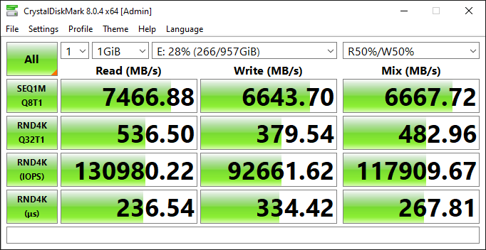

So after delaying the switch of ssd slots, more reading and messing around, and eventually doing a clean install of Windows 10, to no effect, because someone said that worked for them, I switched the slots and found that:
I've kinda come to the conclusion that Crsytal Disk Mark 8.0.4 just doesn't work well with my system, for some reason, and also that there may be some performance degradation going from M2_1 to the other M2 slots. The WD SN850 drive shows much less degradation in CDM benchmarks than the Adata XPG S70 though.
I still don't really get results consistent with reviews from CDM, but AS-SSD bench, the drives seem to perform better than I've seen in reviews, and much closer to each other, which makes sense.
The AData XPG S70 performed more like what it should in M2_1:
The iops seem to be way off, but the sequential is fine.
The WD SN850 showed worse results in M2_2, again with really low iops readout, but not that bad:
The "real world" tests in CDM seem more in line with reviews:
AS SSD benchmark on the SN850 seems in line with a review I saw, with the Adata S70 comparable generally@
Comparable review: https://www.servethehome.com/wd-black-sn850-1tb-nvme-ssd-review-testing-on-amd-and-intel-cpus/2/
Anyway, I've left all of this here in case it helps someone in future. Lesson learnt is that benchmarks can be a bit odd. There likely is still something not perfect in the system, but it seems to operate fine, so I'll roll with it for now.
