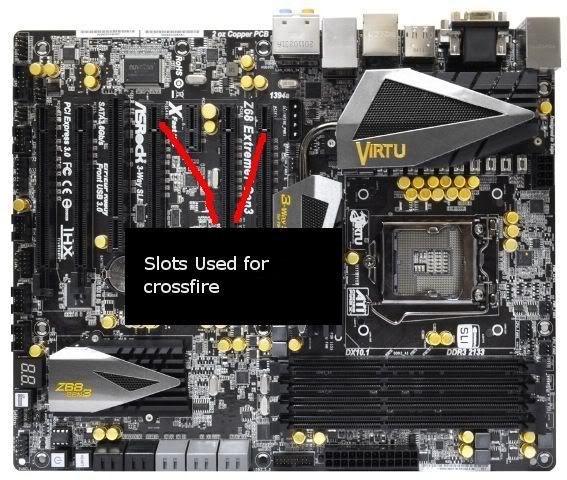

looking to add my GPU's to the loop in the near future, not buying right now will have to wait till the start of next month as i've just had to put the Evo in for work, however just trying to clarify the correct setup now so i can plan ahead.
the cards that will be getting cooled are 2x MSI R6950 Twin Frozr III's, i'm aware there are no full cover blocks on the market for these cards however i'm not too fussed about that, pretty sure i have settled on the EK-VGA Supreme HF Bridge Edition - Acetal+EN (Nickel) blocks, now i'll need a bridge for this.
i'm using an Asrock Z68 Extreme 7, i have the cards set up as follows
am i correct in believing i will require EK-FC Bridge DUAL Parallel 3-Slot for this setup with there being 2 standard slots between the cards?
also i prefer the idea of parallel rather than serial.

You don't need the bridge, tubing alone will be fine, but the bridge can make it easier.
definitely want the bridge hence deciding to go for the more expensive bridge edition of the HF gpu blocks, just making sure i'm looking at the right length one for the setup i have
