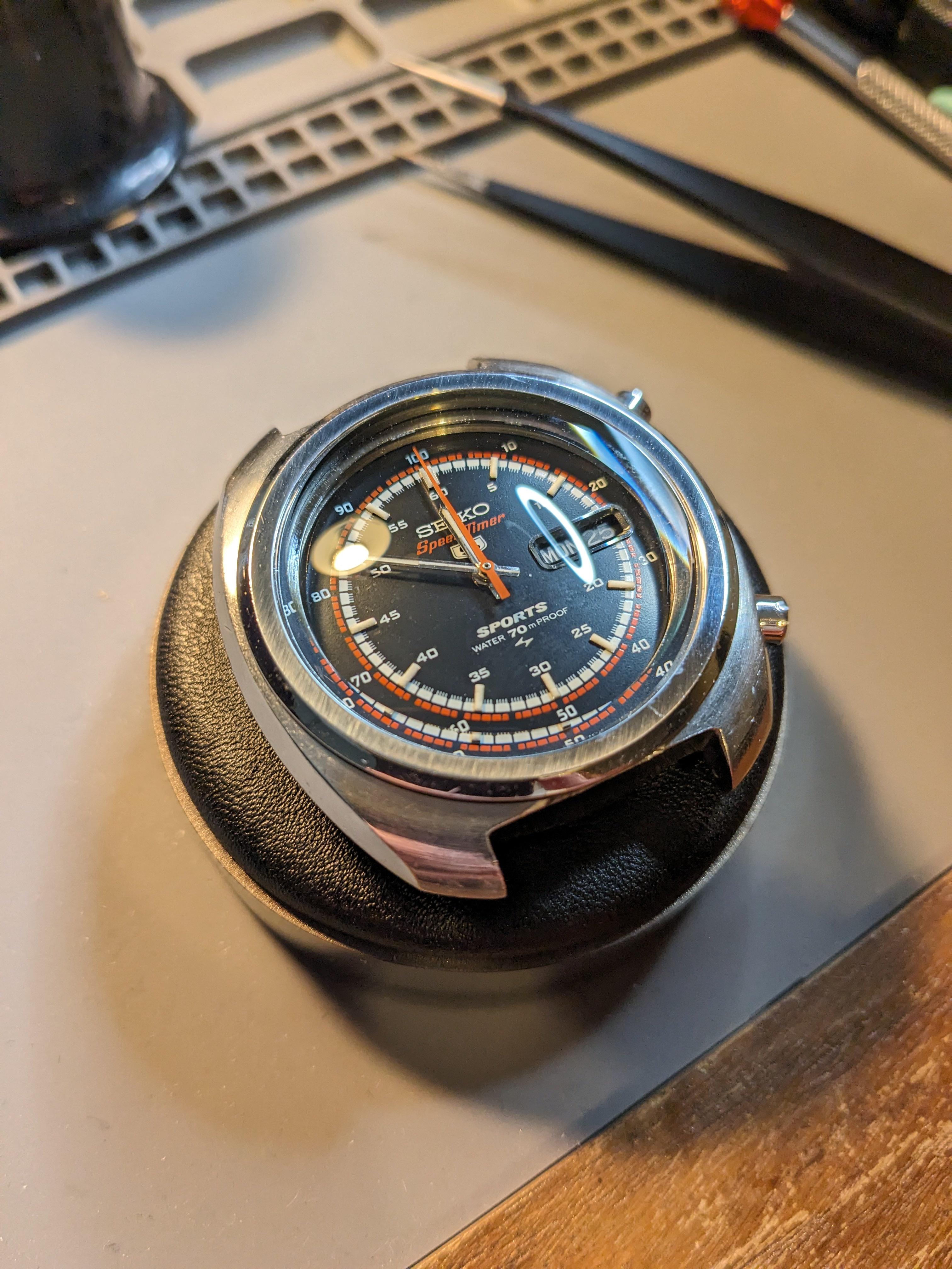

Little bit of progress on the latest project.
Seiko 7017-8000 Speedtimer Chronograph. First watch I bought myself to tinker with, then realised I needed to start with something simpler. :D
Just got this side all built up, going to let it run in for a bit before I have a tinker but the initial numbers look very promising for a 50+ year old watch. I am over the moon with that amplitude and beat error, mainly because I've done no tweaking and haven't oiled the hairspring top jewel yet.
I still have to build the calendar works, refurbish the case and relume the dial but it's off to a good start.
Edit - I had the angle wrong for the 7017, should be 53 degrees. Retested at a very reasonable 0.1ms beat error and 268 amplitude, very very pleased with that.

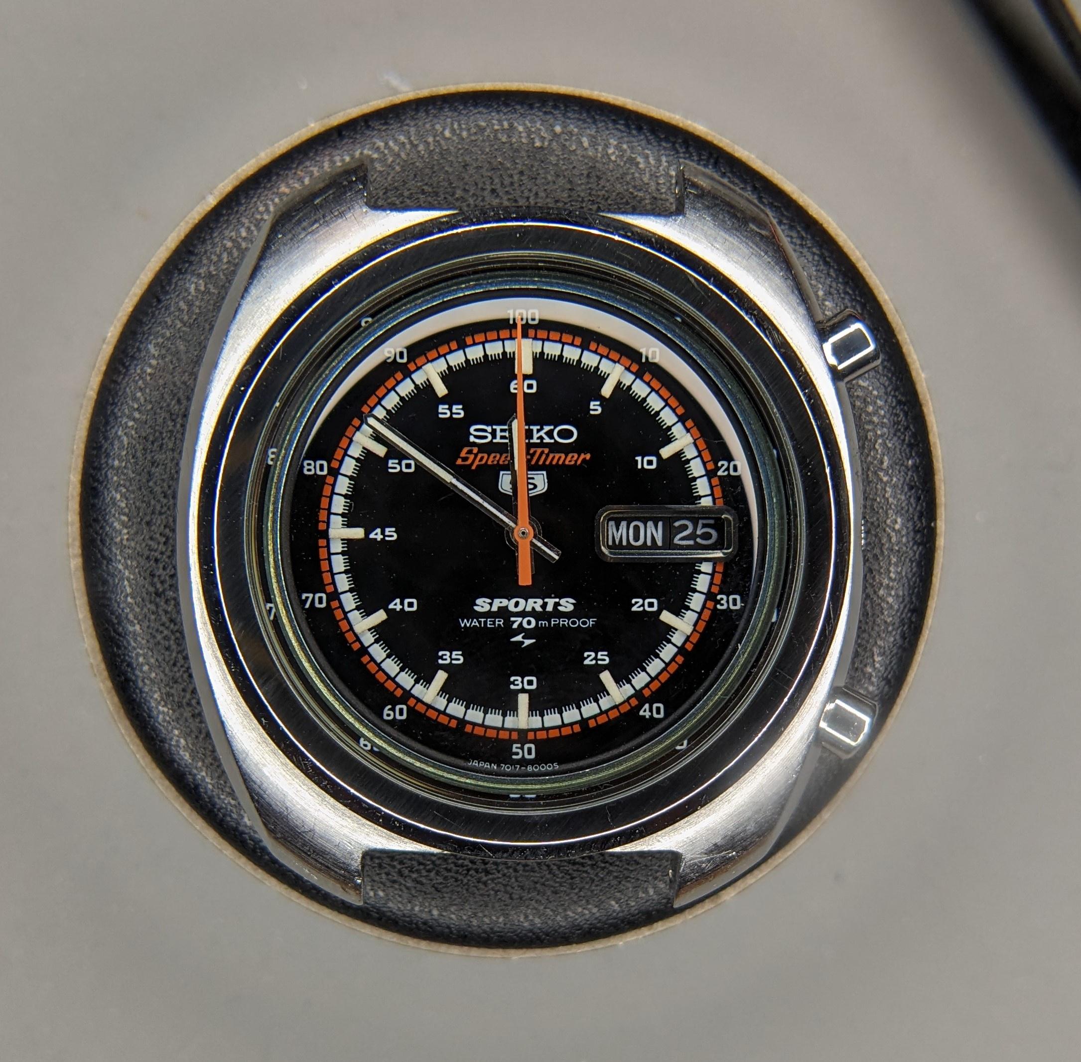

Following on from this post, I've finished putting the Seiko SpeedTimer back together. 7017-8000 Daini Flyback Chronograph.
The amplitude settled at around 200 which is about on par for a watch of this vintage (1971), beat error was down to 0.1ms which I'm happy with given my novice abilities (and lack of proper time grapher).
Went with a "less is more" approach this time around. On the case I've only polished the shiny bits, didn't fancy attempting a radial brushing just yet. I may attempt again in time, but I'm happy with the case as is.
New crystal and gaskets, may replace the pushers and springs if I can find a NOS set for reasonable money (not £80 on eBay, douche canoes). Other than that, will let the pics do the talking...
edit - Just retested the Seiko, that'll do nicely.

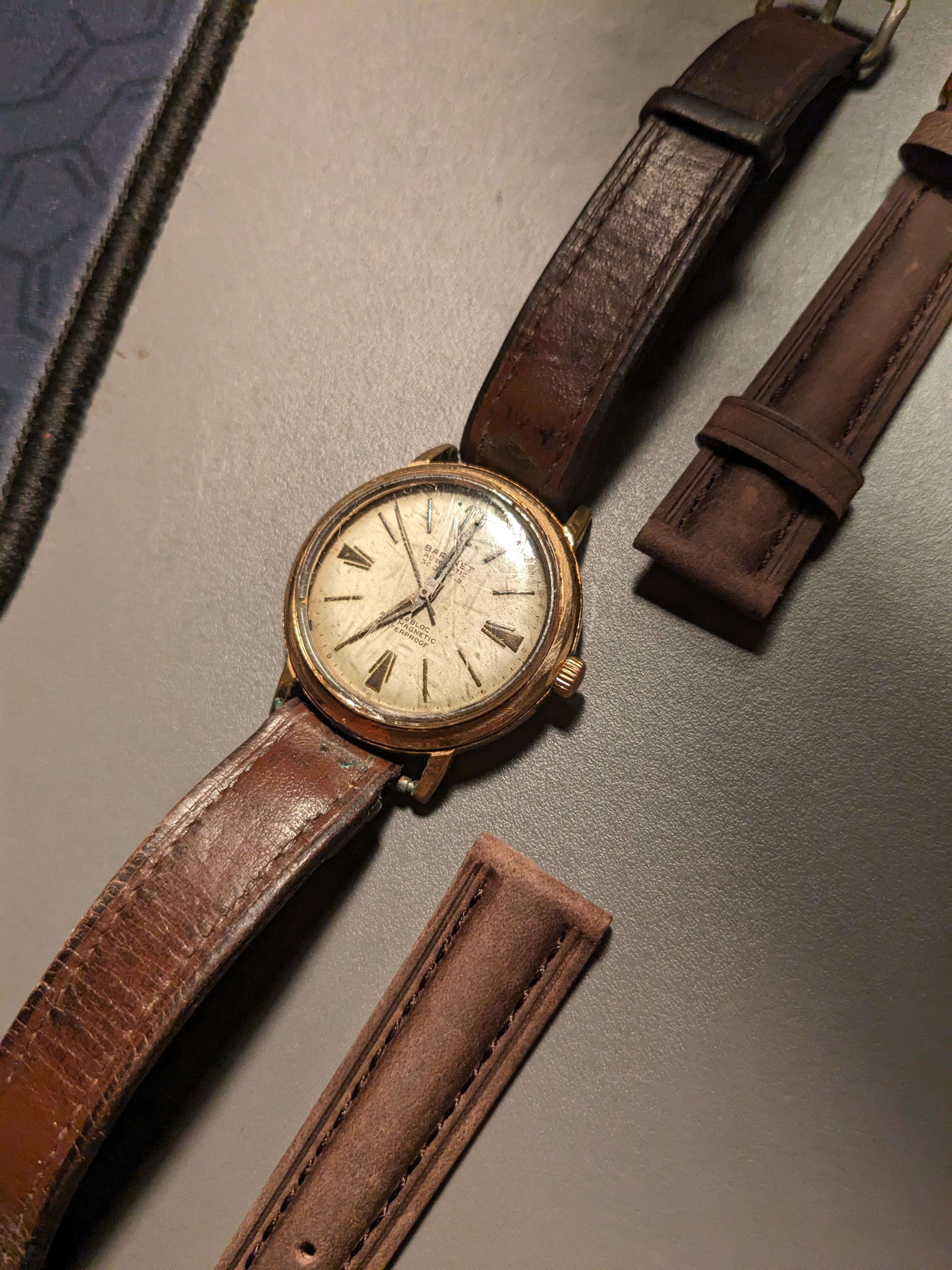

This is on the block next. It's my late Grandfather's Baronet, dated some point in the 1950s. It's a 30 jewel, automatic watch that's probably not been serviced since... pfft... 25 years ago maybe? It'll be getting a full strip down, clean and service and the case and crown will be re-plated. New dome, and strap as pictured. Feel up to tackling this one after doing the Seiko. :)

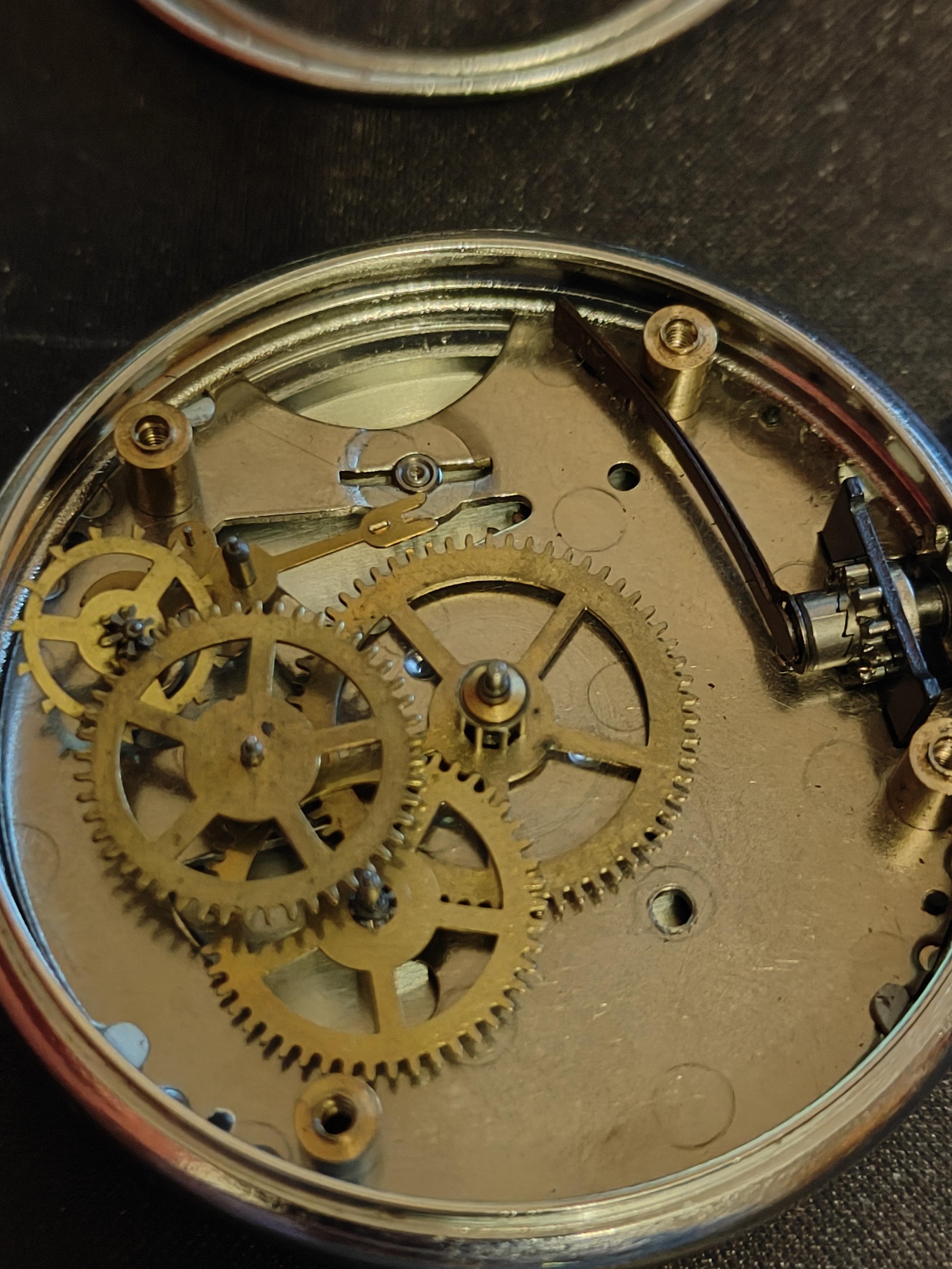

Do you have the full arsenal of tools for a full strip down of a watch? I've got an ebay pocketwatch in piece but I don't a tool to remove the canon pinion yet so I've not got very far with it.
I do. Only cheapies, not plumped for the Bergeon stuff yet. Building up stuff as I go.
Canon pinions can usually be removed with tweezers, they just snap down over the centre shaft. (Assuming your forth wheel is on the outer edge rather than beneath the centre wheel).

I've got some chinese set of 'precision' tools with some pry tools which i removed the main hands off with but I didn't fancy using them on the second hand so it's still on there as well.
I think you need to take the movement out of the case to get to the other side. Just watched a quick video, and it appears to be all friction fit.
Good luck!
Good luck!
I unscrewed the four tiny screes around the dial and lowering the spring bar on the reverse allowed part of the hand setting mechanism to drop out and allowed for the remainder of the movement to drop out from the case. Not sure the tweezers I have are small enough to remove the cannon pinion and seconds hands / wheel though.
