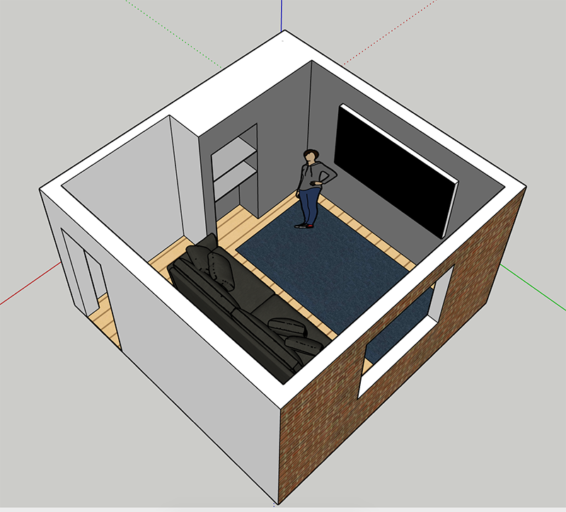

Question is, spend £4K on an 85" Sony Bravia KD85XF8596BU TV or extend the budget to £5.2K for a Sony VPL-VW260ES 4K 3D projector (don't care about the 3D bit, but the reviews look good).
I'm no CAD/Sketchup expert but the dimensions are to scale.
As you can see from the attached, the 85" takes up some serious real estate on the wall so I'm wondering if the projector's actually worth it. Plus the advantages a TV offers - easier set up and the ability to watch normal TV without near or full darkness. Plus less noise. And cheaper.
The wall on which the TV is mounted is 3100 mm wide and 2446 mm tall (that excludes the cupboard).
The full length of the room is 3600 mm.
It shows an 85" TV mounted on the wall (dimensions exactly match the Sony Bravia KD85XF8596BU).
The front of the sofa is 2000 mm from the TV.
The space to the left is a cupboard which can be knocked out but would like to store AV kit behind glass.
Decision time is now. We're mid build and if going for a projector we need to cut a hole in the ceiling for the projector and trail cables to the AV kit before the flooring upstairs goes down. Same for the TV on the back wall if we choose that option.
Interested in opinions. All I keep reading is once you've experienced a projector you'll never go back, but then some online reviews say large TVs a better by miles. So advice from owners of both welcome.

You've articulated my quandary better than I did :) As it's a snug I can make it about the experience and don't want to end up kicking myself having not invested in a projector. I suppose the question is (and not understanding throw distances etc), will a projector fill more of that back wall? I was going to get some floor standing speakers which would have reduced potential wall area for projecting onto, but now mounting all corner speakers up near the ceiling. So there's an extra 500 mm of wall either side of that TV. Hmmm.

Can you treat the walls/ceiling? If so you can have the pj screen fill almost the entire width of the room. It's amazing what a bit of black velvet does for stopping light bouncing around. Looks smart as hell too.
If it's going to be a dedicated movie room, i'd go for a treated bat cave with a pj and the largest screen the wall/viewing distance will allow.

The other thing you want, given that you're going to be spending that much money, is a good "lens shift" (measured as a percentage of the projected image - 10% lens shift means 10cm moved for a 100cm image). I.e. the distance the projector can "shift" the image without having to use "keystone" to digitally alter (read "negatively post process") the image to make it fit the wall square.
A good amount of lens shift is going to let you place the projector higher and thus further away from the viewer (meaning less noise and generally just more out of the way)
Use this site, put in the projector you want and size of room: http://www.reviewtranslations.com/projection_calculator_en.html (you can drag the projector around to a specific place as well)
With your VW260ES you see it has great lens shift but at your size of room (3.6m) only projects a maximum size of 102.8 inches with 2.1x zoom (probably more like 100 inches if you consider the fact you need to wire things from the back so it can't be flush against the wall)
If you choose the Optima UHD40 you'll see it has less "zoom" but projects a larger image to start with and as such, in the same size room, the Optima could give you about 120 inches.
The Optima looks like it has less lens shift but that's not actually true, as again each projector is different and it appears the Sony lets you shift through the entire range where as the Optima works in either "table" or "ceiling" mounted mode and you end up with being able to shift just as much.

Given the size of the room I'd probably go with an OLED to be honest. I think it would look well proportioned in the room with a nice set of floor standers bought with the money saved. You're never going to be able to see true HDR with a projector...

This made me laugh. Only just noticed the hand on the hip. It's a default scaled human component which SketchUp provides. Might as well include a speech bubble with 'HOW MUCH!!' or 'It looks ridiculous it's so big'. Both anticipated responses :)
