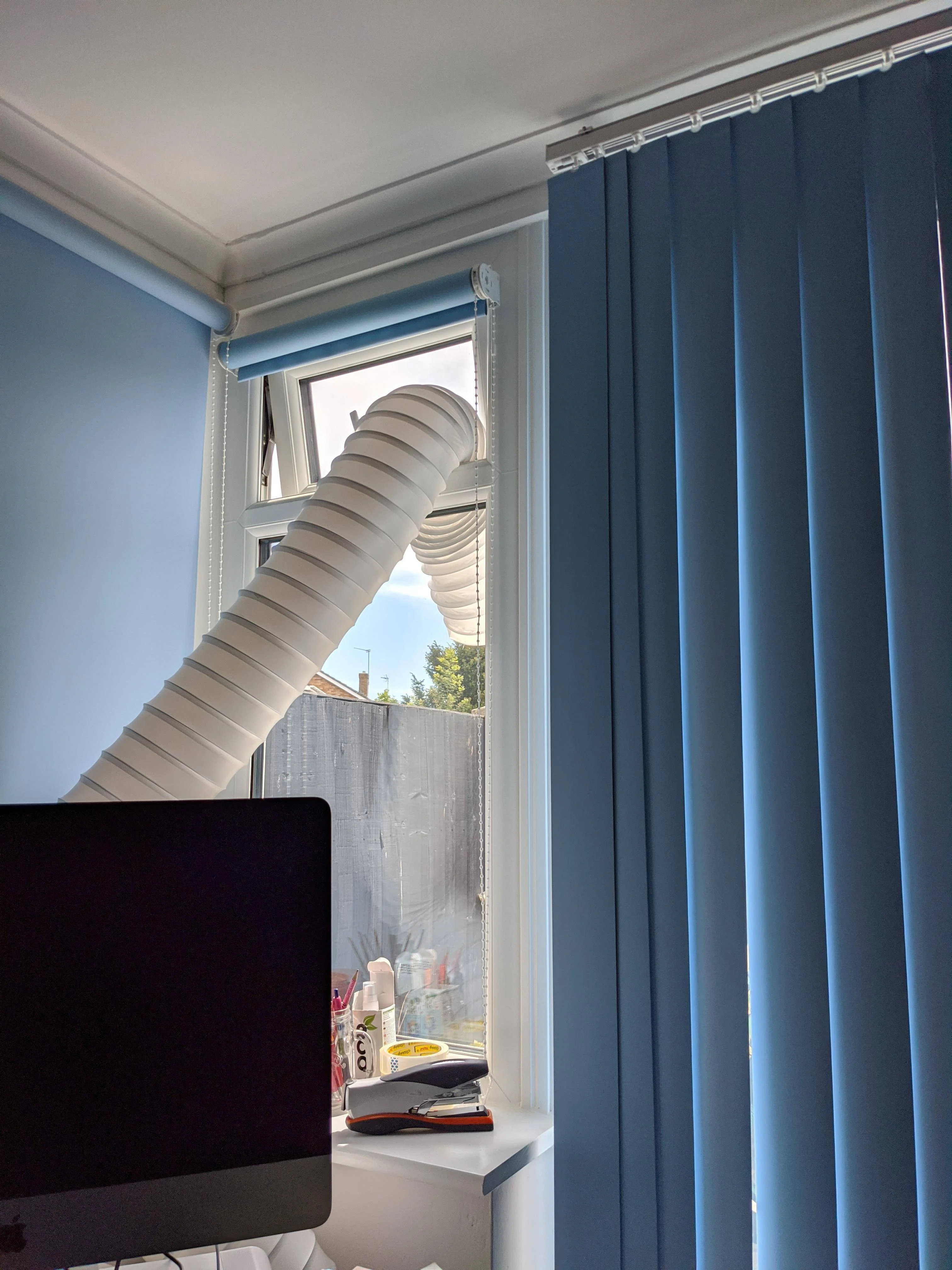

And realised it's about ten times too big for the window... Does anyone have any better ideas, it's a small top opening window about 50cm x 30cm
Right now it works... (See below) but obviously not ideal given the window is open around it.
A clear piece of perspex with Velcro on the left and right hand side so you can remove it when not in use, a hole drilled in the middle 130MM diameter I'm guessing, and pop the pipe through that.
(it's what I did before I had a split unit fitted)
That pipe will get very warm and give off a lot of heat too, I went the extra mile at the time and even lagged the pipe.
Pretty? Hell no.
As above. You could even use cardboard for a quick fix. It probably won't make much of a difference though, its a small window opening and as mentioned, most of that heat is from the pipe before its expelled.
Thanks guys, love the perspex idea (and the cardboard ha ha :D) I genuinely need to get air con installed, I flirt with the idea every year, but it's the cost combined with where do I have it... Im thinking just the lounge downstairs and our bedroom, or the lounge and the upstairs hallway with the idea it would 'cool' the landing and the bedrooms upstairs enough to benefit everyone... Hmmm...!!!
I'd start with a piece of cardboard - and order a piece of flexible white pvc. If you get the cardboard right, you can use it as a template for the pvc.
