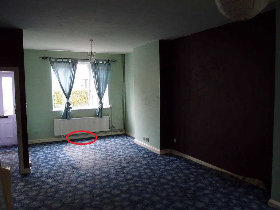

This is what I think it is left over from, as there would have been an open fire place in the front room originally, or at least before it was knocked through into one room.
Here is a picture showing the location of the void leading to the vent/grill: -
Its just as i mentioned so brick it up if you want.
Thanks, will do. Thought that might be the case.
I have a similar vent/grill at the back of the property, roughly here: -
Tomorrow when I remove the plaster in that area I'm expecting to find the same, that is a void half above & below the solid floor. The only difference here will be that there is no plinth so just the 9" wall.
usually air vents for fireplaces are higher up the wall ?
Down at that level sealed behind plaster and a skirting board would not supply enough air for a fireplace.
I would still go that at some time in the history of the house it had a suspended floor and the vents were to give ventilation under the floor, especially as there is one at the front and one at the rear to give a good through flow.
