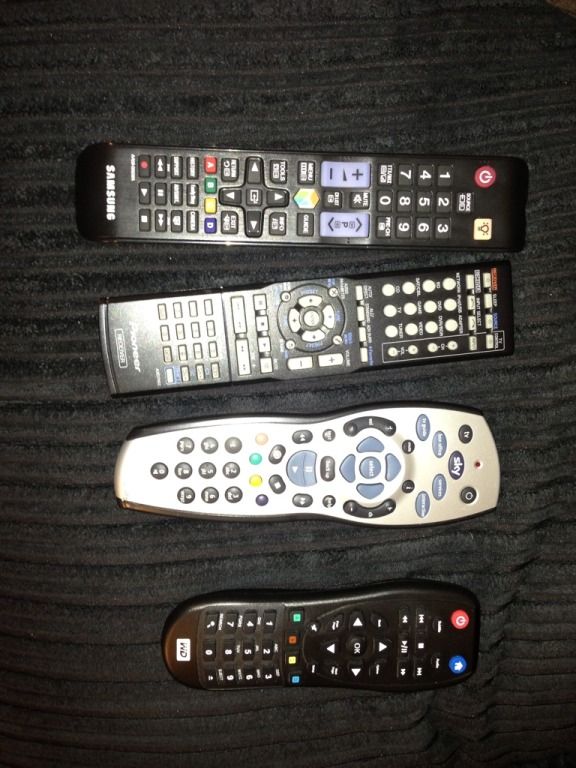

Hi guys,
I'm looking for an all in one controller so I can get rid of the below controllers for everyday use. I know Logitech do some, are these the only real ones out there to get and will they definately control what I require?
That's for my Samsung TV, Pioneer AV, Sky and WD Live device. Pretty new stuff so I can't imagine what I want being an issue?
