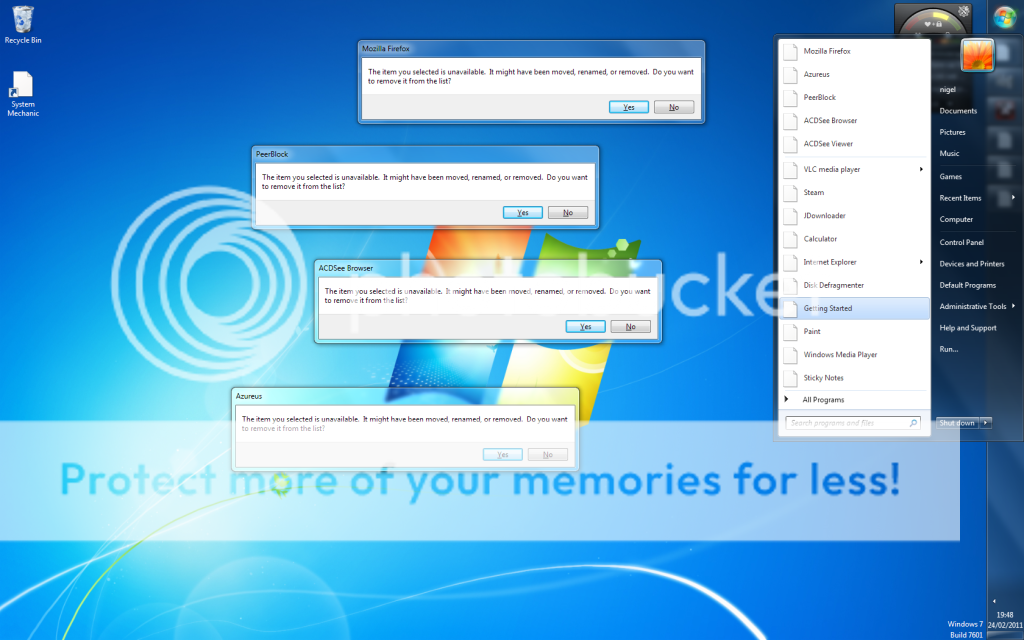

All my shortcuts are blank and non-functional

Unfortunately I did not realise I had no restore point before I started mucking about with that POS optimiser program.
Well tbh, if I can't find a solution I'll just reinstall. I have win xp sp3, win 7 utltimate and this win 7 ultimate sp1 installed. I don't make partitions big enough to accomodate service packs extracting on the OS partition.
I'm just limping along atm, can open programs with windows key + r and task manager and they hold a list of recently opened programs. Ouh also windows key + e works, just read about that searching for a solution.
That crap program killed all my sendto list. I will have to look up where the sendto folder is again. Edit: no the sendto shortcuts are there but same problem.

Ok just email the guy back after he sent reg file to fix it and told him what I thought about his program. It looks good atm back to normal. I would have probably been ok with it but getting banned from that forum is ridiculous. All I said was that I suggested a user uninstall this program since he got no reply for help in 7 days, and there was spammy chain letter type posts on the board.
I tried two programs before the registry file:
Iolo System Mechanic
had a fix shortcuts routine which didnt fix my shortcuts, I think it was an answer in a yahoo question.
TweakNow power pack 2011 also did not fix it only the registry files.
