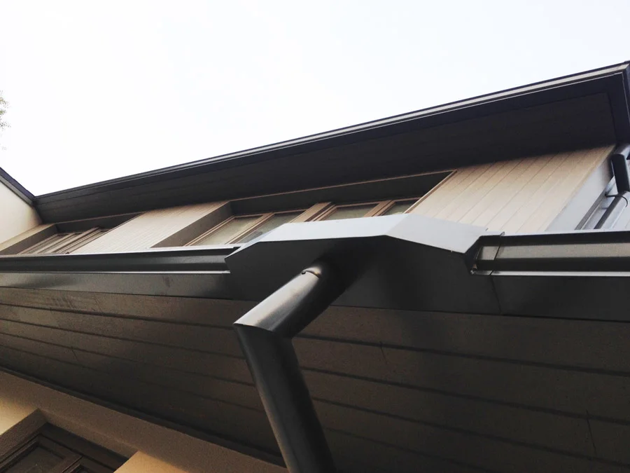

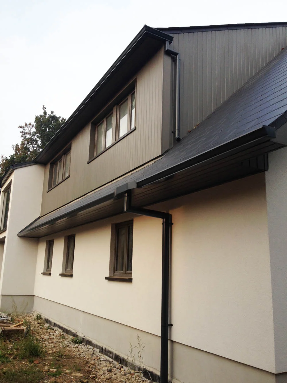

we just recently had aluminium gutters fitted to our new build.
yes they are expensive but they look great, and in particular they really complement the house.
you can pick any colour, the seamless look is brilliant and when properly maintained they last a very long time.
I like em a lot!
