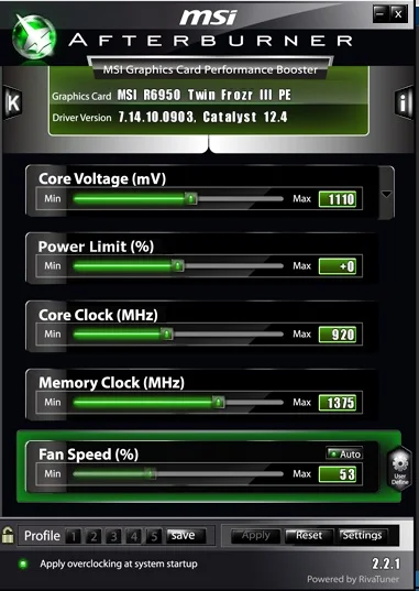

Hi guys, this is my first post on this forum, so forgive my nativity. I was recommended by some of my friends to come here if I had a question.
I have an MSI ATI Radeon HD 6950 OC Twin FrozR III Power Edition 2048MB GDDR5 PCI-Express and I've been overclocking it.
(unofficial overclocking enabled - highest I could go to was 900 on core clock and 1325 on memory)
I found this is the highest I could go without crashing to desktop. I'm pretty new to overclocking, so I was wondering whether I was undervolting, because I heard somewhere that a higher voltage will help it work better. I'd also preferably like to go higher if that's possible.
Should I be increase the voltage at all?

In my experience with my 2 6950s they will both go to 980/1400 with 1.3v but i wouldnt try it, try upping volts a little, id say anywhere up to 1.25v is fine, with 1.175v i managed 940/1375 and it was solid.
Just up it to 1.175 and run benches. Maybe even up core clock, upping memory doesnt really give massive gains with the 6950 so i normally stay at 1325 or 1350. Dont go crazy on the memory or it might pop.

Thanks for the quick reply.
I'll up the voltage to 1.175v and run some benches...try to up the core clock a bit.
Also, I thought you were only meant to up the power slider when doing benches? (I have it on 20 when doing them)

I can't seem to be able to change the voltage.
Kombuster is telling me it's at 1.15, GPUz says it's at 1.2, when in afterburner, I have set it to 1.175.
I know it isn't changing, because I still got a crash to desktop when upping the core clock to 930. Do you know how to get it to recognize I've changed it?
Could it be to do with the mode I have set afterburner to?
UnofficialOverclockingEULA = I confirm that I am aware of unofficial overclocking limitations and fully understand that MSI will not provide me any support on it
UnofficialOverclockingMode = 2
In the interface for MSI AB there is an option to unlock voltage control, did you do that? As far as im aware it should work if you have changed the cfg file to the above EULA confirmation and ticked unlock voltage control.
Yep, I've ticked it.
I don't know why, but it's as though it's giving the wrong reading. I locked it to stock settings again (1.11) but GPUz still said it was at 1.200 and kombuster said it was at 1.15. No matter what I change it to, they stay the same.
Not sure if this is related, but it also sometimes it decides to automatically move the slider 0.001 below what I put it at. For example, at 1.175 it moves it to 1.174.
Should be:
[ATIADLHAL]
EnableUnofficialOverclocking = 1
UnofficialOverclockingMode = 1
AccessibilityCheckingPeriod = 0
UnifiedMemoryUsageMonitoring = 1
As stated above, watch your memory clocks, I really wouldn't go above 1350MHz, and if you leave it at say 1300MHz, the core will probably go higher.

Hi. I've pasted that into the config.
I already knew how to overclock, although now I know to pretty much leave the memory alone. Also thanks for the benchmark suggestion. I'll leave a comment in a little while.
However, my problem now is that MSI afterburner is not actually changing my voltages when I move and apply the slider (according to GPUz). Could you please take a look at the previous comments please (they state the problem in detail)?
I really dont know mate, I wonder if the volts are locked? Never heard of your problem before. My volts work fine through AB once i unlocked voltage tweaking in the AB interface.
