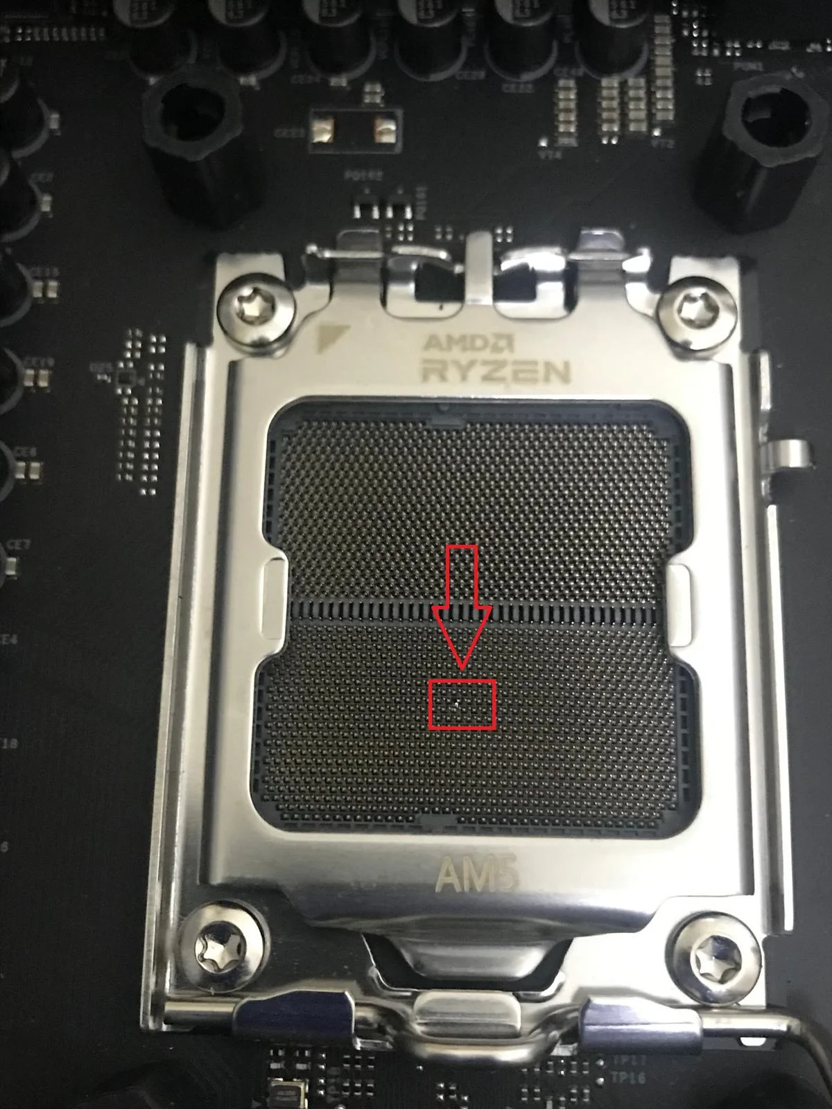

I have a question: unfortunately, during shipping, one of the pins on my motherboard socket (AM5) got bent. I checked the socket pinout, and it seems that the bent pin is a VDDCR pin.
I’ve been using the motherboard for about a month now, and everything has been working perfectly—no issues at all.
My question is: can I consider myself “safe” at this point and just forget about it, or is there a chance the situation could get worse over time?
Before installing the CPU, I took a picture of the socket (attached to this post). Unfortunately, the picture isn’t very clear, but it looks like the bent pin is very close to another pin. According to the pinout, that one is also a VDDCR pin. So I was wondering: if the two pins are touching, could that cause any problems? Or, since they both are VDDCR pins, would it be harmless?

I’d love to take a clearer photo, but I’m too afraid to remove the CPU and risk making things worse.

On the assumption you're keeping it (which you probably shouldn't have done) then it'll *probably* be ok.
If the pins haven't already touched then with a CPU clamping them down they shouldn't move.
It's not ideal, I'd personally not be happy running it like that but then again as mentioned I'd also have not accepted it or tried my expensive CPU in it.

I picked up a board off the members market with about 6-7 bent pins a few months back.
Hour or so with a microscope and a couple of pins and it’s been right as rain ever since.
I wouldn’t worry. :D
Since you bought it used from a private seller, you're probably not going to be able to return it, anyway. If it works, it works! I don't really see what could happen to cause the pins to move even more while a CPU is already installed. Also, the image is not high-resolution or zoomed in enough to where I can tell with certainty, but it doesn't look to me like the pins are touching. Close, yes, but not touching.
My advice? If it works and isn't causing you any issues, then keep it as-is and don't mess with it, you could make it worse. Those pins are easy to break if you don't know what you're doing. If it was broken, then you're likely to have experienced issues in the month you've used it. I don't see why it would start to randomly cause issues months after installation. That pin isn't going to move or change its purpose, so you should be fine. I think you can probably rest easy.
