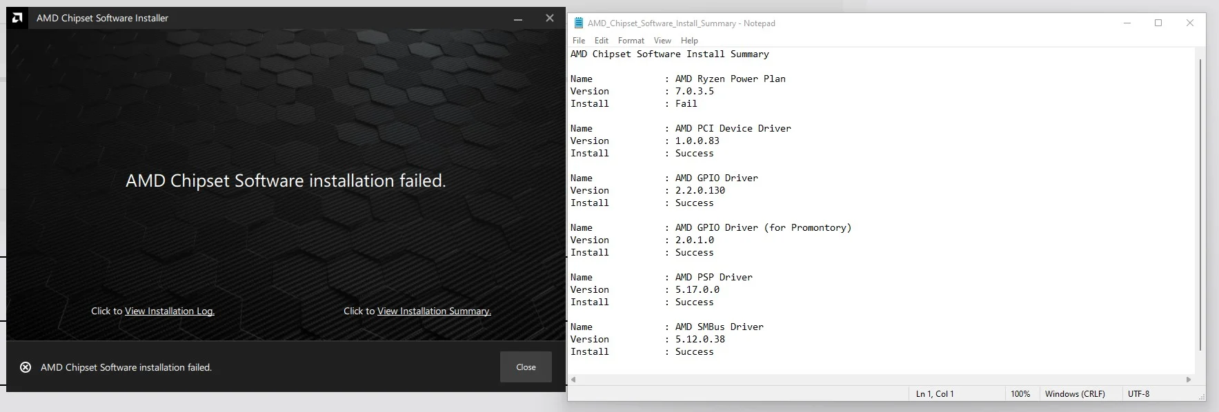

Hello Folks,
I have tried to install the AMD Chipset drivers numerous times and for some reason they aren't installing fully. They install everything bar the Power Plan.

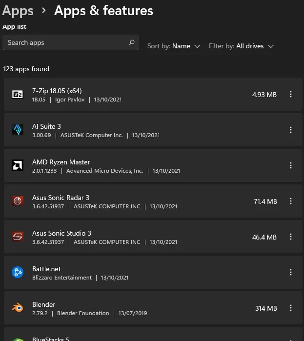

But the Chipset Drivers don't show up on my Apps & Features area on Windows 11. So I gather they are not being installed at all. Does anyone know a fix for this?
Try disabling your antivirus and then try to install.
This was a known issue a while ago, which I also had experience with. But I thought this was now fixed.
What CPU are you running?
The power plan is for everything other than the 5000 series.
When installing the drivers with a 5000 series chip the power plan is now part of the default windows balanced plan.

I'm pretty sure i had AI Suite 3 prevent me from installing the amd chipset drivers, from what i remember it also took over power plans and had options inside AI suite.
Try doing it after you (good luck) fully uninstall AI suite 3.
So I've got the AMD Chipset Software installed in Windows, but I don't have the power plans - really confused.
Didn't AMD get rid of their power plans several years ago after the 2 series launch as it was no longer required? I can't remember the last time I saw AMD power plans on my Windows 10 pc and have installed every chipset update since.
