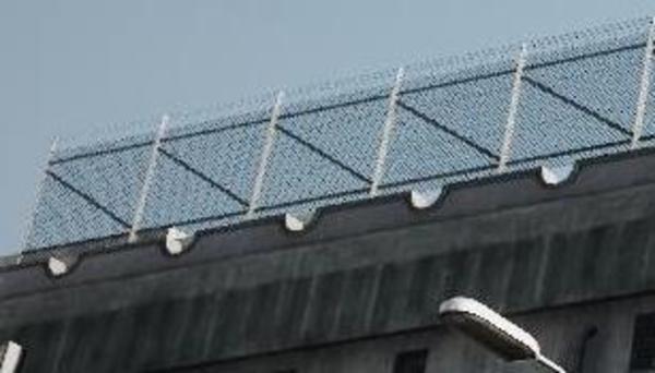

Pictures.... Hopefully you can see them and they haven't been compressed too much.
MSAA - Off
MSAA+TrSSAA - On
MSAA - Off
MSAA+TrSSAA - On
MSAA - Off
MSAA+TrSSAA - On
Best thing to do is open them in a separate tab in your browser and flick between them.
Even in this heavily compressed state you can clearly see how more more defined and better looking the tree's are in the pictures.
The difference while in game is more more apparent.
I can see the difference, but it doesn't stick out like a sore thumb. However if the performance hit is small then ill definitely use it.
