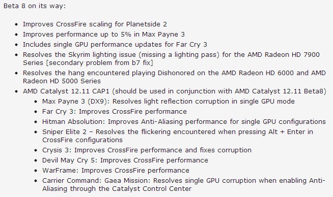

Beta 8 on the way, more performance improvements. :)
Crossfire fixes for games that aren't released yet, amd really are stepping up :)
Huge improvement on last year's "wait 2 months then fix it" attitude :)
