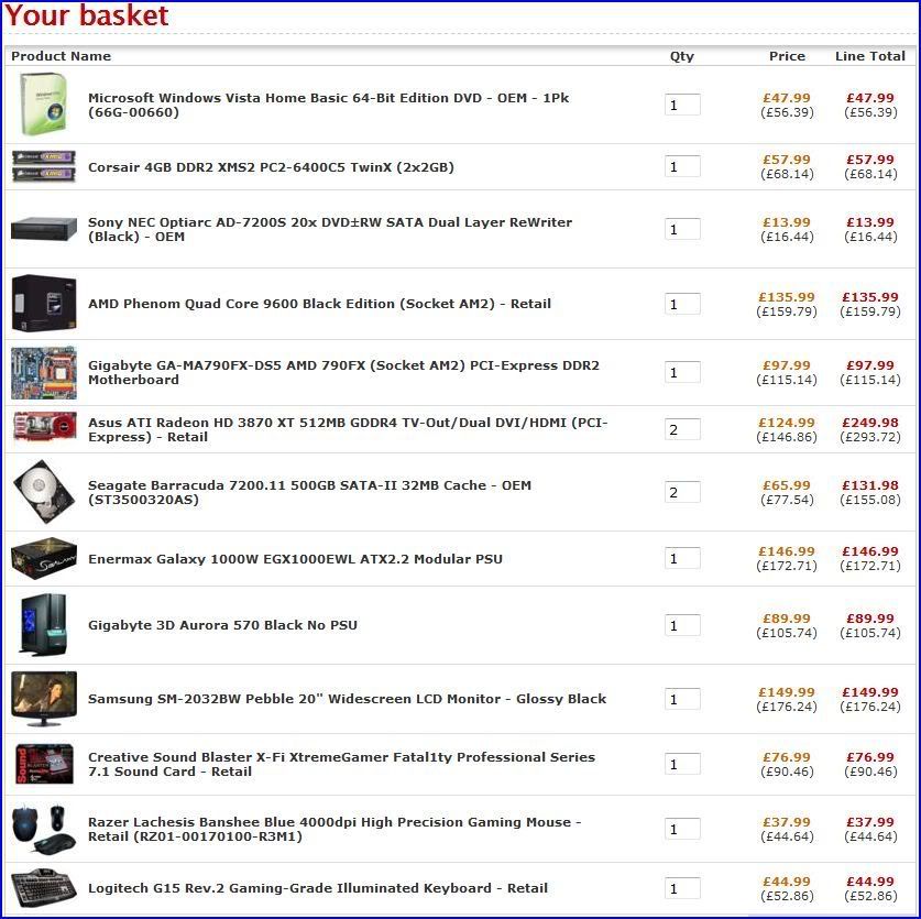

Hi guys could you please have a look at this spec please for a friend and tell me if anything is wrong with it or what i can change. It comes to £1535.46 where the spec he did was over £2100???????? I apologise if the pic is to big. SORRY!!!
Any reason for speccing two Radeon 3870 XT? I would say a single card Radeon 3870 X2 would be a much better idea and a few quid cheaper too. Also a 1000 watt PSU for that system is way overkill - can't see it needing anything more than around 600 watts to be honest.
Other than that I'd say that looks like a fine system.
Cheers Phemo the rig he did was using a 1000w psu so i wanted to try and do the same spec as him but his spec was with 2 x 3850's as well. I was just seeing why he would have got a rig priced at £2100 when i can price up a similar one for £600 cheaper.
Hi smyth i'm an intel man through and through but he is AMD and won't listen to reason (Strange Man) so that is what he wants.
Mp260767 thanks very much.
