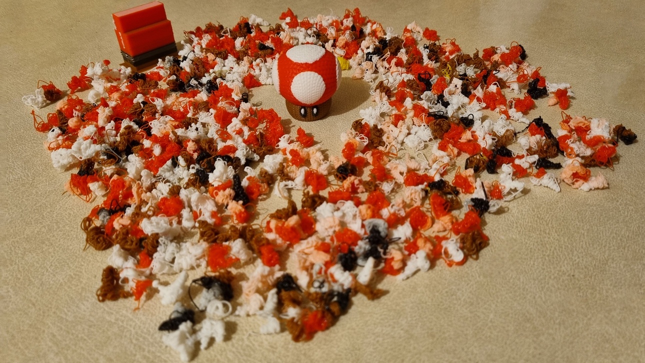

its nice to have many colours to print or just use it as a filament rollover ... but the wasted material when actually printing colourful models is really bad
see example from someone in another topic
