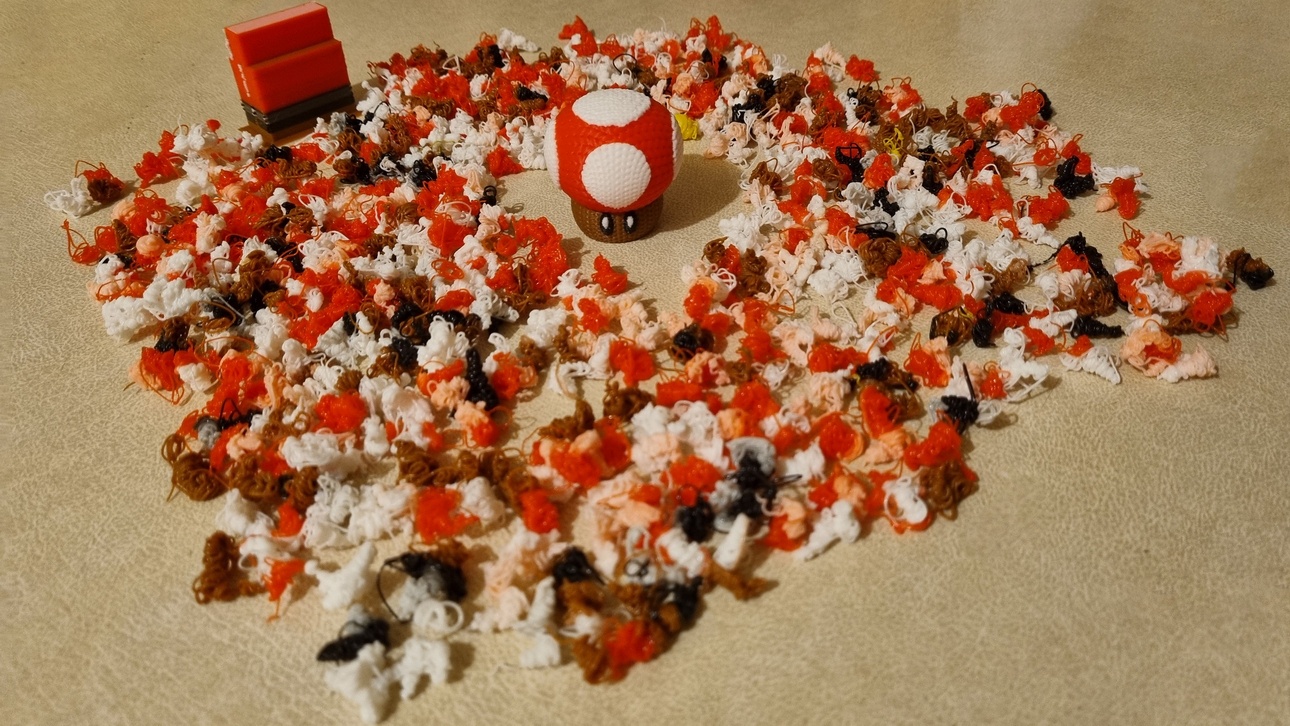

Houston, I think we have a problem.......
First ams print turned out good, but omg the poop. I knew there would be a bit but not this much.
The default 'flush' settings was 0.7, and I've changed this to 0.6. Also 'Flush to infill' is now ticked. Anything else I could try??
Not really much you can do, Ideally I would have wanted to have printed the white circles of the mushroom along with these eyes separately and stuck them on, probably not be so great as it has a crochet effect though. Unless you're printing multiple of those off, the AMS isn't very economical.
That is why I am still thinking about going with toolchanger :)... If you doing large batches for sale it's OK.. But if you are printing for yourself it is just so wasteful
I think i'll have to print multiples then :)
I have another 3 of those to do to complete the set. I'll change the flush settings and hope for a bit less poop. Thanks.
