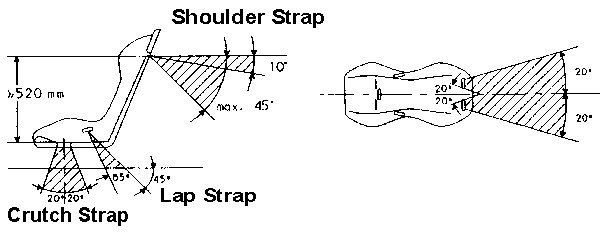

They attach to the rear seatbelt mounts on the rear, is that bad?? :confused:
They have the seatbelt spools though don't they?
I think he means if it just bolts to the floor and has no play in it then it could hurt, or I'm completely wrong. :p
InvG
It's the angle of the harneses that's the problem. They are supposed to be mounted at a horizontal, or as close as possible.
With then mounted on the floor like that, huge downward forces are placed on the backs of the seats in an accident, and it can cause the seats to break, along with your spine.........
thanks for the pic, L. saves me typing up a load of stuff...wm5 is getting old. fast.
if it were mine, I'd ditch that half cage (it looks about 8" from the shell!), fit a proper cage and mount the harnesses within 10 deg. of horizontal.
nice though...needs a 35i conversion... ;)
*n
Pricely sum of £700
Might look at getting a harness bar or similar for them, i'll double check the angles tonight and see what can be done.
