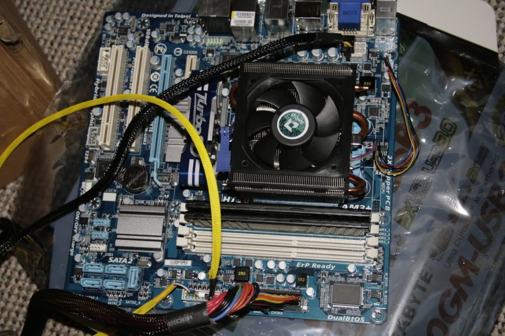

So happily unboxing my stuff today. Doesn't post.. well i don't think it does as the screen is blank. I'm thinking a DOA CPU [AMD FX-4170]. The mobo has power in all the right places and using the PSU now. Tried both PCI-E and onboard GFX and still nowt! Tried the usual swapping RAM, BIOS battery, etc. Any thoughts?
Mobo: Gigabyte 880GM-USB3
RAM: Corsair Vengeance 8Gb DDR3 1600
CPU: AMD FX-4170

If it is the right board, then would you be able to post a couple of photos of the motherboard and all the connections you have made? just in case you missed something.

Just checked, the mobo is rev 3.1 - well get the photos shortly when camera batteries are charged. Thanks again.

Yes, looks like the right connections. Though does your 630W PSU not come with an 8pin ATX power connector (usually arranged as a 4+4)? If so, then I would plug this power connection into the ATX 12V socket (next to the CPU) instead of the 4 pin.
Also, if that is an anti-static bag that you are testing it on I would take it off there before you test it again - since those bags are conductive and can short your board. Instead testing in a wooden table, on cardboard or in the case itself (on the stand-offs) would be better options.
Well i did try the 8-pin connector after it didn't work the first few times and still didn't work. The static bag was only used for the photos, it wasn't powered.
EDIT: Just tried the 8-pin again and the PSU makes a strange screeching noise. Doesn't happen with the 4-pin.. so would this indicate a power issue? Also just picked up a speaker pack from maplins, will report back soon!
