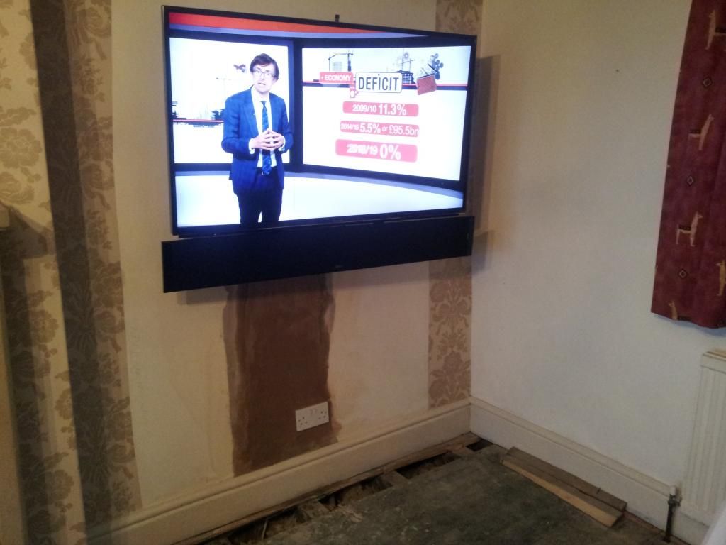

Here's an 802 with a KEF soundbar and swivel bracket I installed for a customer in Colne about a week ago. It's in to a 18th Century farm house. The room is part decorated in this pic.
The plaster was crumbly too, but that was only an issue because I was chasing to bury power and signal cables and install a double power socket behind the TV. I removed enough to get back to sound surrounding plaster and then replastered with base and top coat.
The client could have asked for surface trunking rather than concealed cables. That would have looked awful with such a nice room and great TV of course, but the bracket install would have been just the same.
