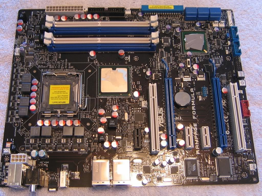

... Walaaa, No more NB/SB Heatsinks. Ever wonder why your NB gets so warm, have a look at the compound job ASUS did. One thing I've been doing on every board I buy, is reworking the NB & SB even if I don't replace the stock heatsinks.
... and the board with the NB, SB and V-REG heatsinks removed:

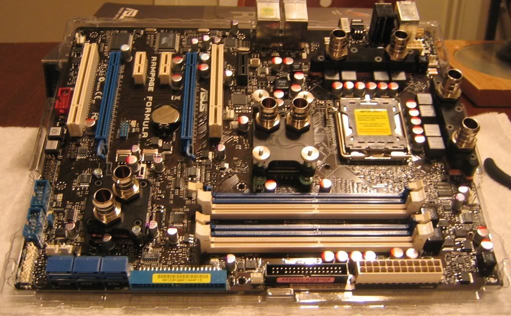

... EK blocks installed, just for test fitting & plumming:

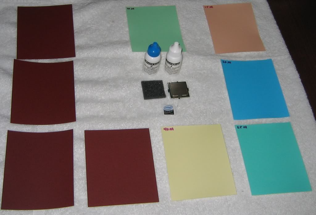

I used a bit of foam, the processor backing plate and painters tape to seal off the backside and edges of the CPU while I was lapping it.
Sand Paper Used (g=Grit, m=Micron): 400g, 600g, 800g, 1000g, 40m, 25m, 20m, 15m and finally 10m.

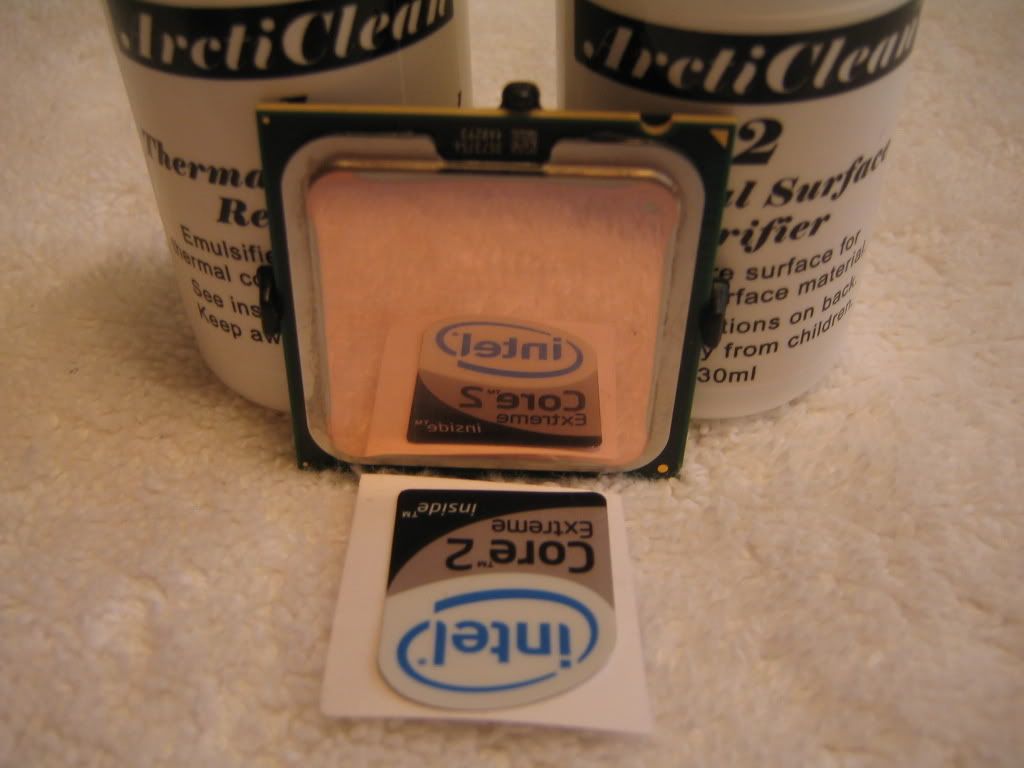

... Here it where it started from. Getting the CPU lettering in the pic was not an easy feat as it was written in a very light silver. I did the best I could with the antique digi cam that I have.

Ok .. After about 30 to 40 stressfull minutes of lapping, wondering if Im killing the thing, here's the results. Could have done a better job of cleaning the edges before I took the picture :) You can see by the edges, the IHS was certainly not flat, as there is still a bit of knickle remaining, but I was a bit twitchy about taking it down any further. You can't see it in the picture very well, but the extreme edges are beveled about 1 mil on all four sides.

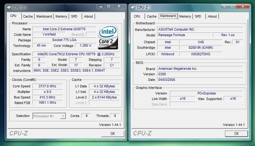

... and yes, before you ask, the CPU is still alive and kicking :D .. I bumped up the FSB, left everthing else stock and was well impressed. My test rig is on marginal air. Looks promising to hit 4G's easily.
