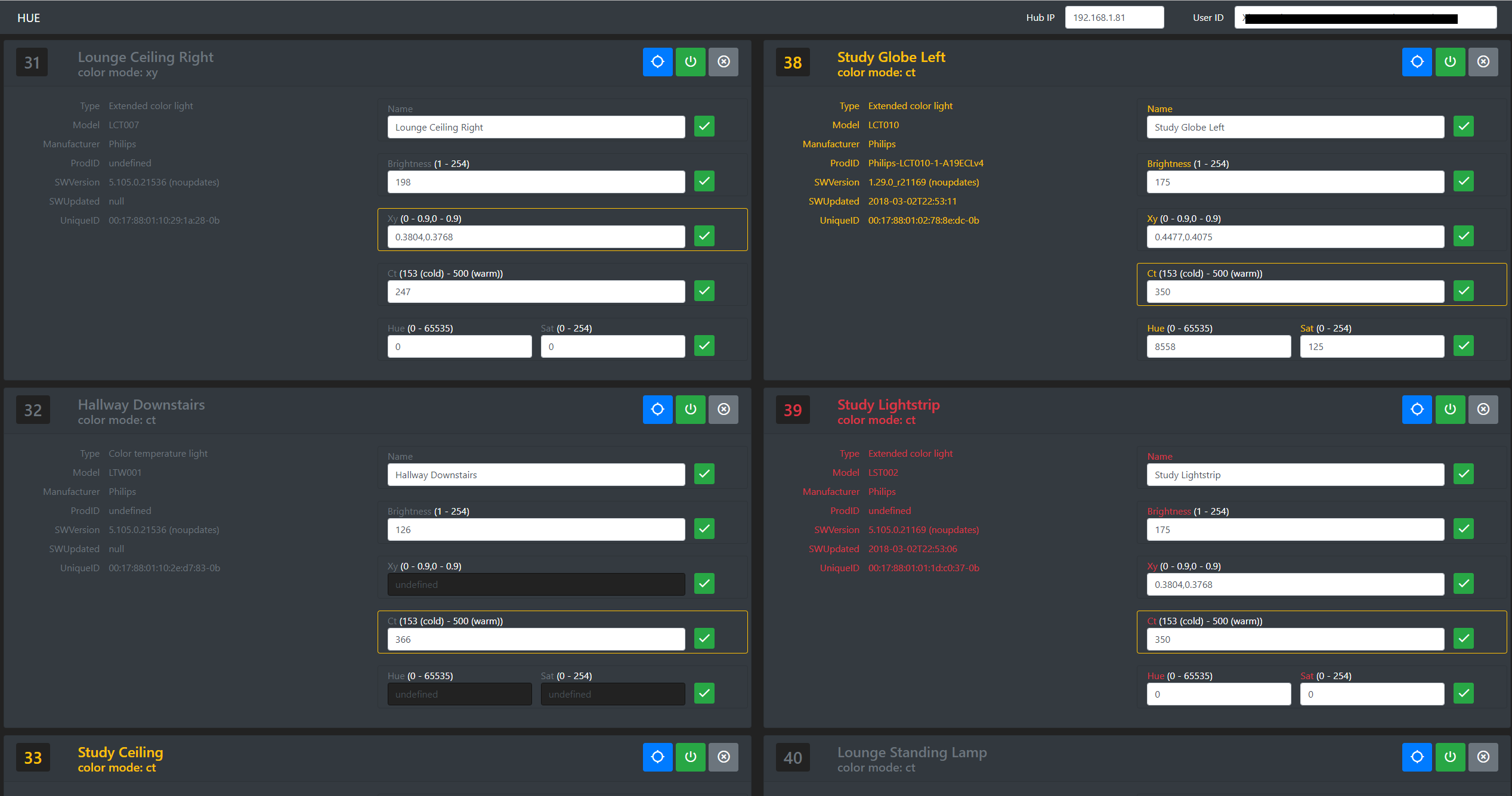

It iterates through all of the bulbs on the hub, and outputs a bootstrap card for each one. The template HTML data is filled in so that each one displays the id, name, some utility buttons (left to right, and some values that can be modified.
I have colour coded the text, if it's grey it's on and reachable. If it's orange it's on. If it's red it's unreachable.

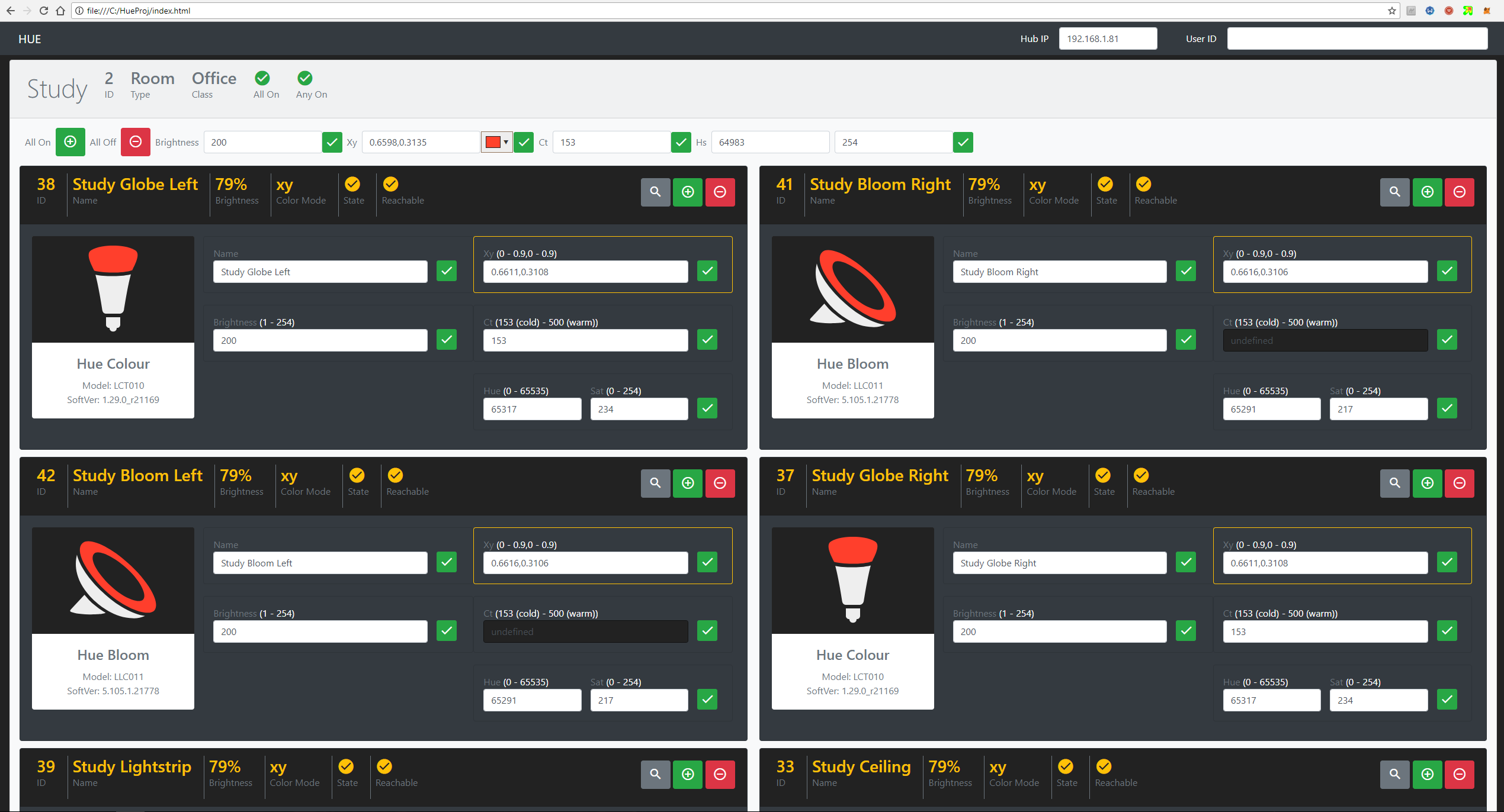

I have been modifying it a bit look and feel wise, I like the new styling a bit more and I have a bit more control over the light settings. Added a colour picker which makes selecting the xy values of the group a lot easier.

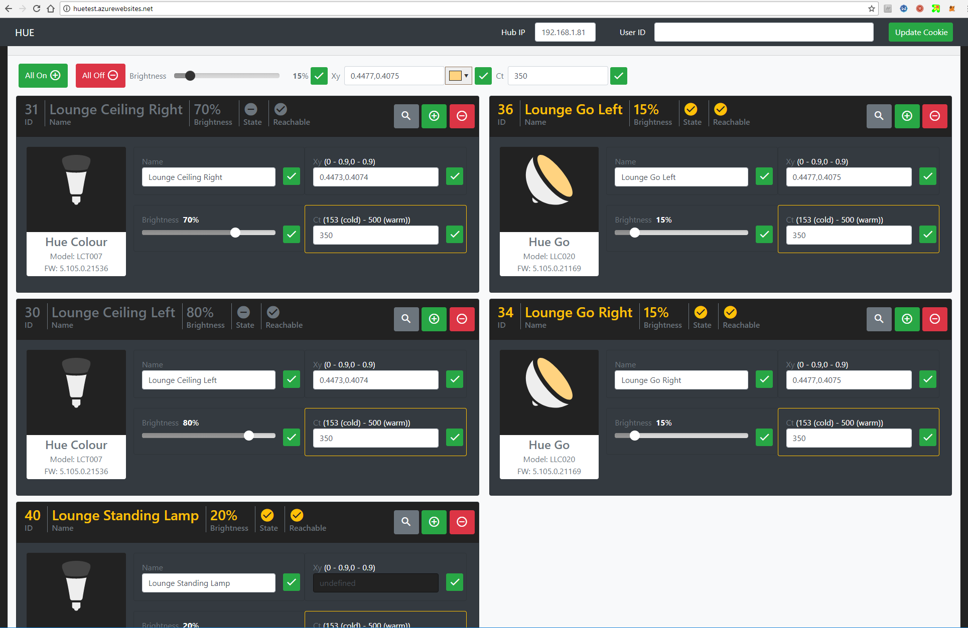

I've created an azure website to test it on so anyone can try it.
http://huetest.azurewebsites.net/
Basic instructions:
1. You'll need a whitelisted API user id to run it with. This is very easy to get with the PowerShell below. Just replace my bridge IP 192.168.1.81 with yours, hit the button on top of your hub, then run it all. It should return a long series of letters and numbers.

2. Put the Hub IP address and the user ID into the two boxes at the top of the page, then click the update cookie button. This will save these variables as cookies so you don't need to enter them each time you load the page.
After that it should just work, at least it does for me :)
Any feedback is welcome, the API is reasonably big and I haven't looked at everything it can do. At the moment it's just getting the lights, groups, and scenes and generating the page content based on this. The scenes aren't even being used for anything yet I was intending to add some functions for them.

It should work a little better in thinner viewports now, as I was designing it all around how it works on my massive screen. I lowered some of the padding and re-arranged some things.
I've added brightness sliders in 5% increments to the lights and the groups.
Removed the hue/sat values as I think they were probably more confusing than anything else. You can generally set the colour values via RGB translation to CIE, or via colour temp (ct) from cold to warm white depending upon the light capabilities (see the bottom one below can't do colours so it's currently not displaying as on, which is something I wanted to sort out).

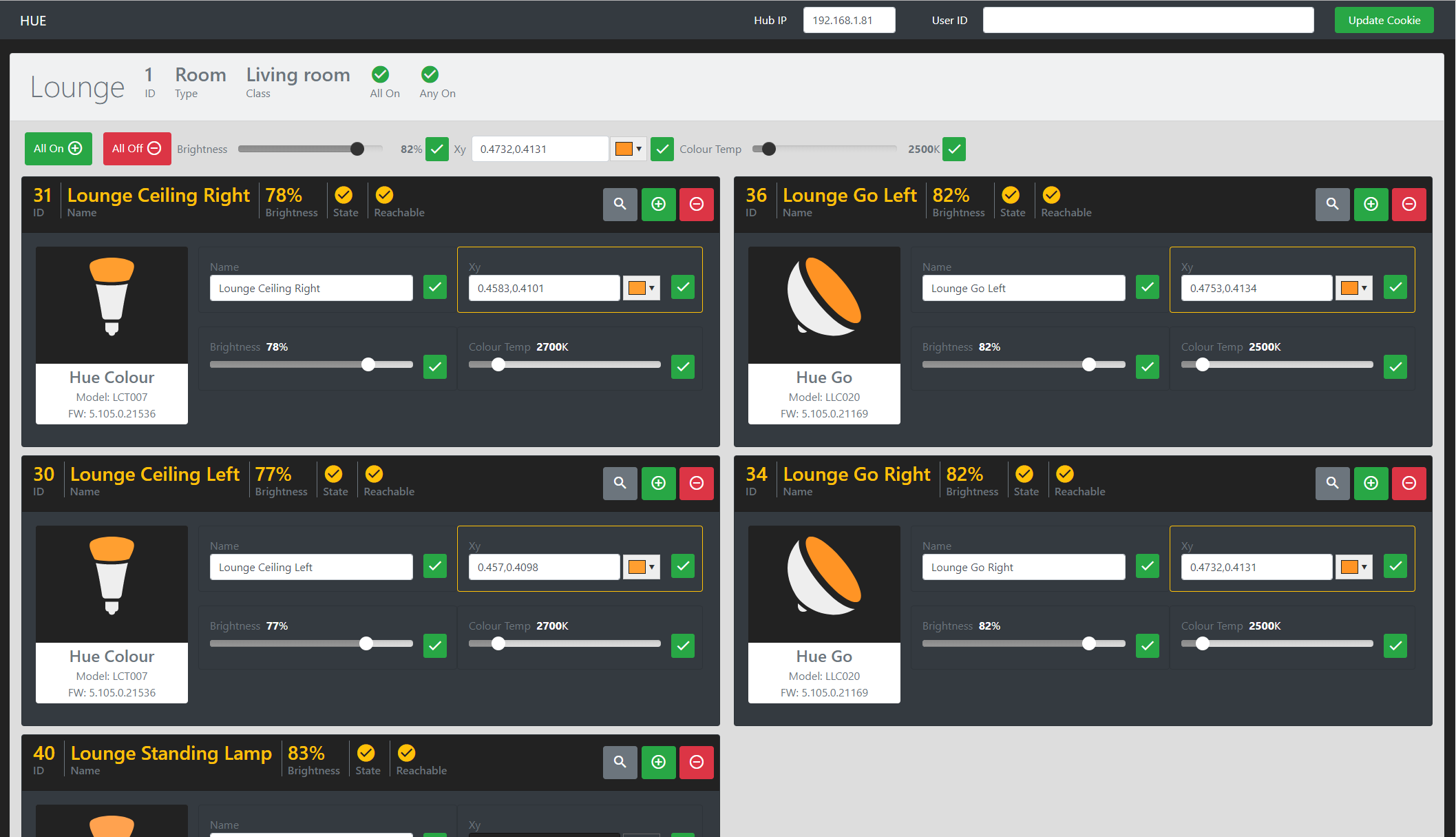

Current iteration on a less wide image:
Is this better?
I've added some scene controls as well, at the moment it's just "load scene", "delete scene", and "save current bulb settings to scene" in that order. Can't delete a scene that is locked which is shown via the icon.

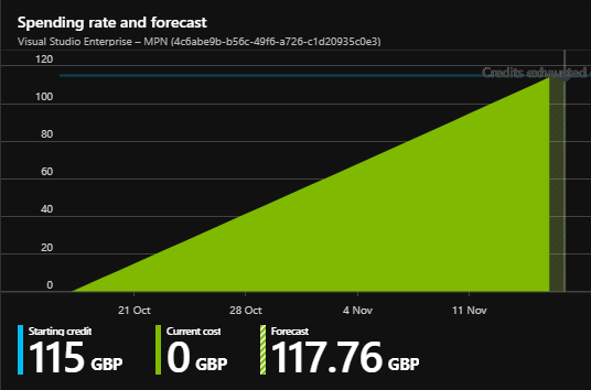

I apologise sir but my Azure credit ran out! :(
I get $150 a month to play with or whatever through my work, but I left my personal VM running so it died before the billing thing renewed.
I think it's due to kick back into life in a day or two though so please bear with :)

It's not paid for exactly, at my work we do a lot of business with Microsoft, so to get us on board with more "Azure" stuff we all get £115 a month to spend on Azure for free, but it doesn't rollover. Basically a use it or don't use it thing.
