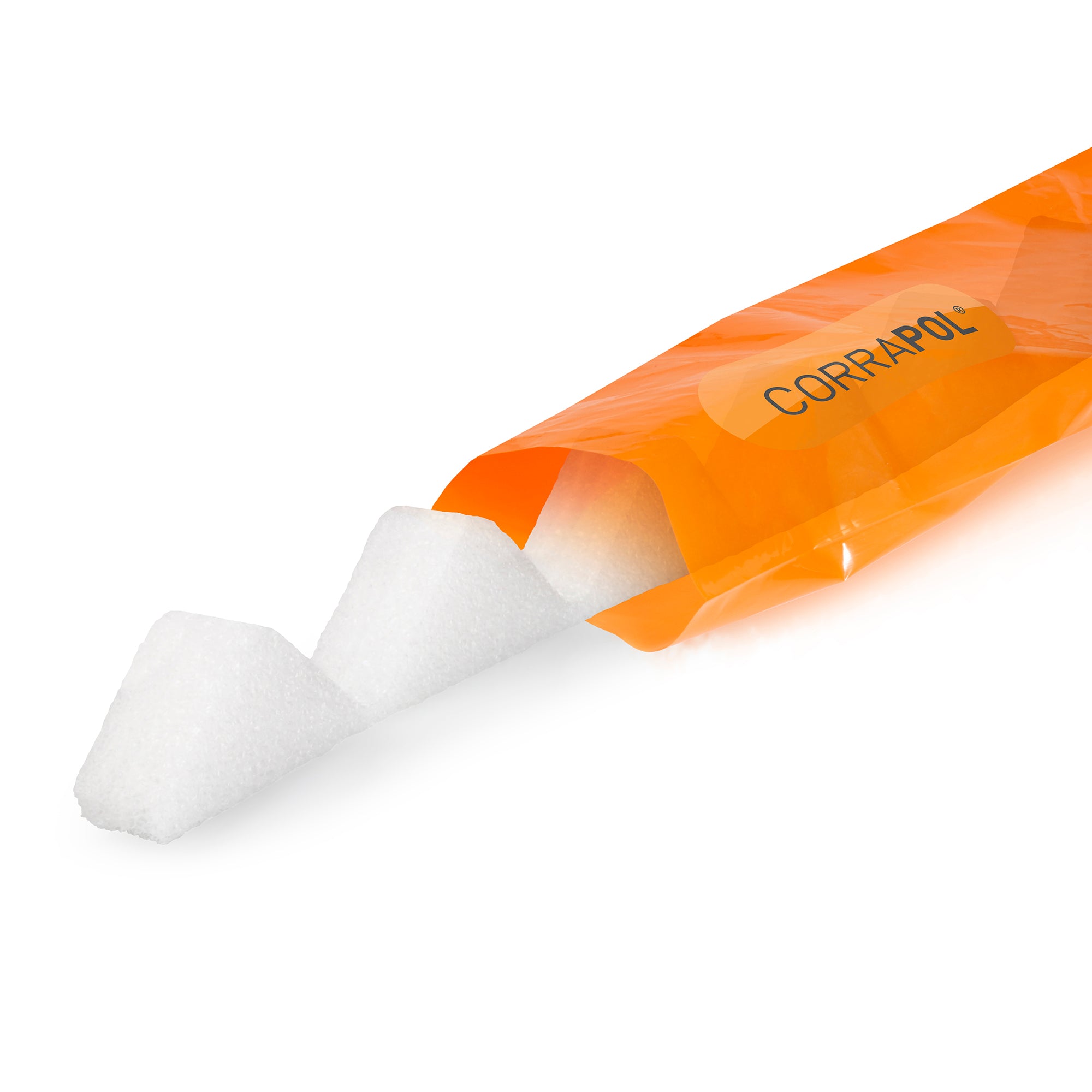

I've approximated I'll need six of these. It doesn't have to be 4m exactly as long as it covers most of the garden path, 3.8 will be fine
I would spend the extra for polycarbonate roofing but that one is available off the shelf 1.5M which is perfect size
