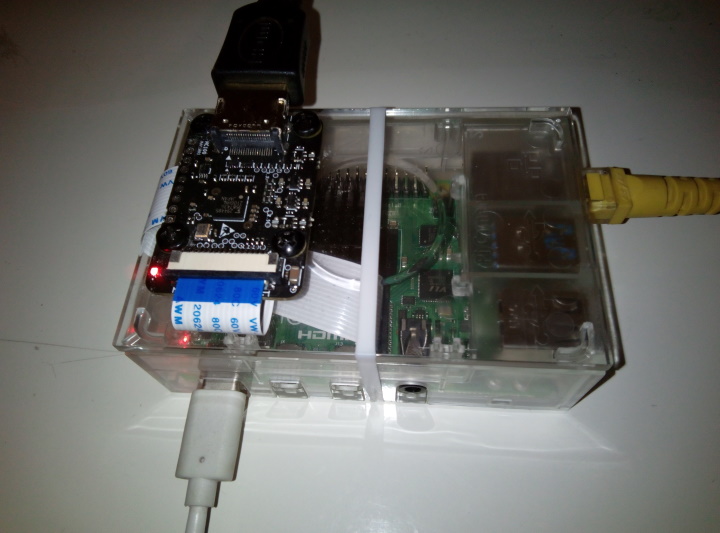

No, I'm still looking myself. I currently have a simple perspex case with the adapter resting on top.

Having spent a lot of time searching for a good option among the hundreds of available cases I've come to the conclusion that there isn't anything that won't require some sort of modification. I therefore decided that I might as well modify my existing case. It's only a cheap clear perspex thing but I mounted the CIS adapter on the top using some motherboard stand-offs. It doesn't look great but at least the adapter isn't just hanging off the ribbon cable anymore. It'll do until I come across something better.

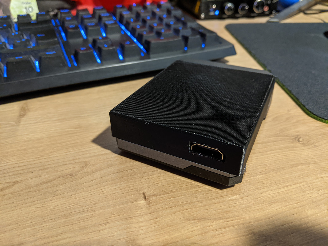

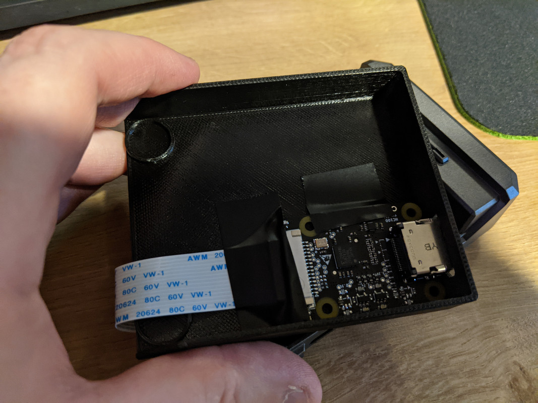

Woo-hoo! Got the case put together, with a lot of thanks to @andy_mk3 who made some changes to the CAD model I got from Thingiverse. Sadly the HDMI port was about 3mm out when I got it printed (down to the original Thingiverse model, not the printing), so if I was going to do another I would make a change to the model and move the HDMI port 3mm inwards. In the end I just took out a little bit of the FDM with a very sharp craft knife.
Due to the lid being very shallow, the HDMI/CSI adapter has to be held in place with some electrician's tape - even the heads of some M2.5 nylon screws, from my Pi box of tricks were too tall!
Original Argin Neo case:
New case lid:

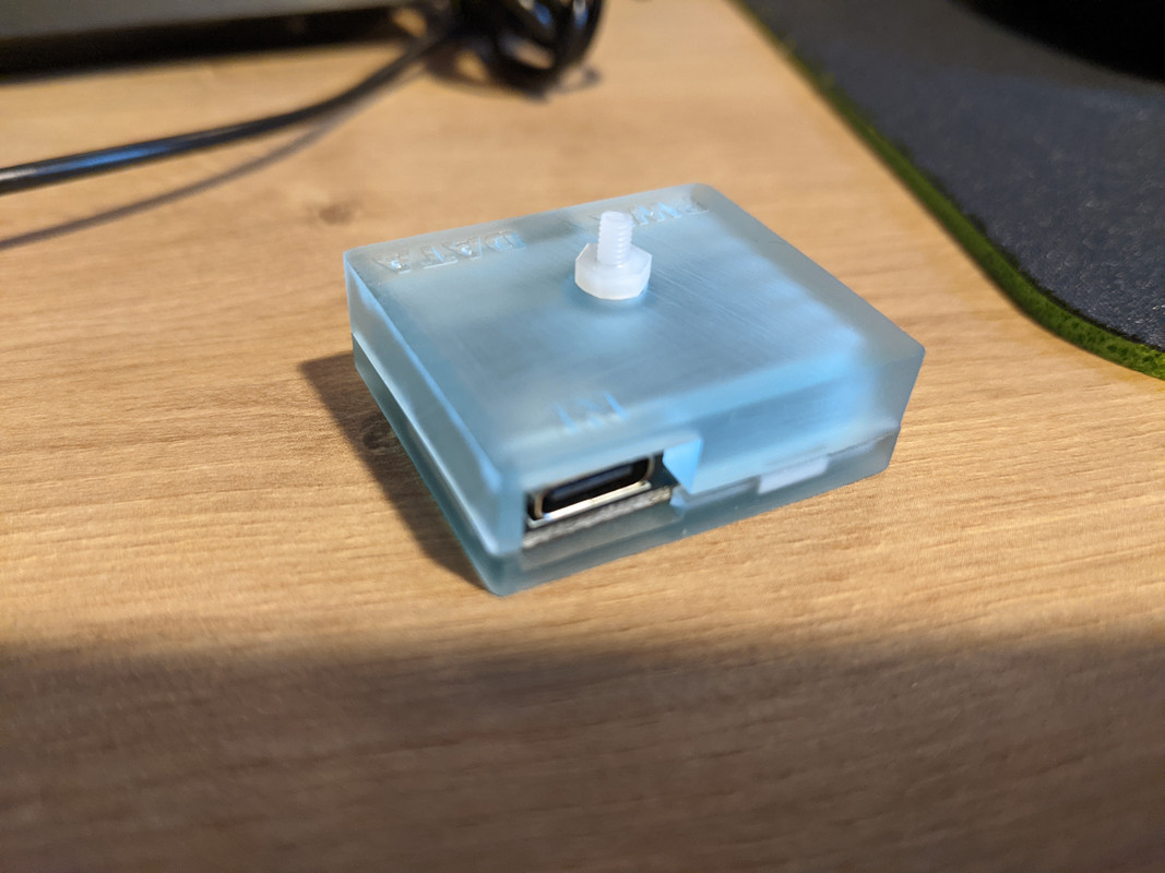

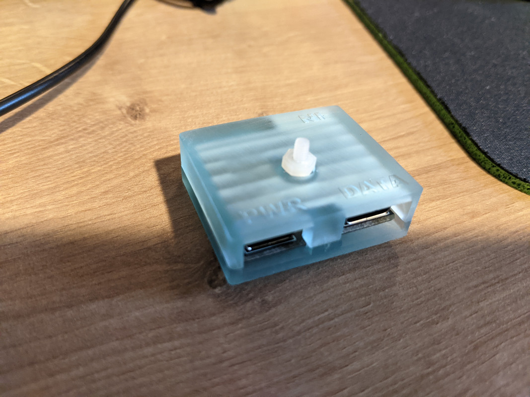

And this is a print of a little case for the USB-C power/data splitter from Thingiverse. If I get the case reprinted, I might do it to match this little adapter case:
Very pleased with the printing of the adapter case especially. Printed with clear blue SLA.
