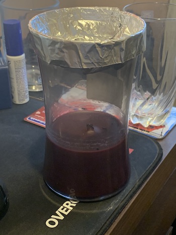

The larger Yankee (jar) candles always have a ton left in for me, as do the larger pillar (church) candles. The pillars are best for burn time but there's always a chunk leftover unfortunately. I've bought a bunch of different brands at different price points and shy of buying the thin dinner candles there's always excess.
With the larger candles, you need to burn them longer for the first burn - e.g. for the larger Yankee's it's around 3 hours so that the whole surface of the candle melts right to the edge. If you don't, then you experience the leftover wax effect known as "tunnelling". Once you've done a first burn, then subsequent burns can normally get away with shorter burn times without much issue.

I looked into this a while back and if you decide to make your own candles, then get a double bolier, do not just melt wax in a pan as the flash point of wax could cause a fire

Are you trimming the wick on new candles and prior to lighting used candles?
The wick is supposed to be kept trimmed to 3mm.

15 years ago I used to run a candle factory in China, making for all the major UK retailers, and was involved in the EU committee at the time responsible for what are now the EU stds and test methods for candles. I could post so many technical documents on here about candle design, candle testing etc it would make you wax over... as it would me.
What i will say is at the time, Ikea candles were great - were always taken as the benchmark standard in the UK.
Fragrances were not the same, typically cost of fragrances in Asda candles at the time was up to $5 per kg, Next / Debs up to $16/kg, M&S up to $20 per kg, and branded like Jo Malone etc. up to $100/ kg. Fragrance loading was also very different. Asda would typically have 2-3% fragrance in a candle, M&S 4%, Jo Malone 8%.
More fragrance didn't make for a better candle, and neither did colour, as these impurities would result in incomplete combustion and smoking. Jo Malone candles burnt poorly, but smelt great.
Tunnelling, as previously mentioned is generally the result of a poorly designed candle, either due to shape, poor specification, or quality control, though room temperature can also effect this, as candle in a warm kitchen will generally burn better than the same candle on a cold windowsill.
You also obviously get different waxes and quality of waxes, typically at my time cheaper candles contained up to 30% soya wax, though this didn't necessarily create a worse burn. The braiding and wick core were also critical, good wicks were cotton with a tin or glass fibre core to help them stand up, cheaper wicks were made of other materials and had a plastic core. Enough. I could write an essay and bore you all more.
Keep going, please.
Very interesting read, thanks for chipping in! I didn't think the subject could be so interesting until I started looking into making my own. I could definitely do with some better wicks, the ones I have are a PITA, tend to snap very easily.
