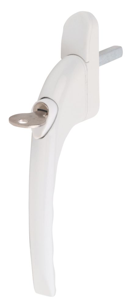

maybe I badly described what I want - these are handles I had to buy the other week - window is digital, its open (with no catch) or closed - no intermediate secure but open option.
The handle isn't what gives you a night latch. It is the mechanism itself. Check the "runner" that your window lives in, it should have 2 notches - one for fully closed, one for ajar.
I have the same handles and for me the window itself can be opened fully or opened a crack and then the handle closed again. Perfect for leaving a window "open" all the time.
OK when you said runner I'd looked at hinge mechanism/slots as exposed at base where there are moving runners, but now see that keeps on opening side of frame, have notch for ajar position,
as pep77 mentioned - I live and learn
However I now understand why previous owner had broken/90%sheared, the handle shaft, because there is inadequate clearance on frame to have handle in full closed position when ajar.

well the ajar isn't really adequate for opening bathroom after shower, & even upstairs bedroom, a mechanism that allowed window to be robustly held further open would be good
