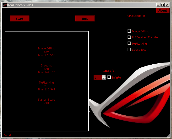

Asus ROG Real Benchmark
[email protected]
see my sig for the rest of thespecs of the system
3570k showing its weakness in the encoding which is no surprise ofc. This is actually a really good benchmark maybe not for everyone but for Us at OcUK it tells us how a system is performing and where it sits in comparison to other set ups in a very quick and informative benchmark.
+1. Spot on I think.
Agreed, but for all but the graphics system. Upgrading my old 5870 to a 770 makes no difference in the scores (I didn't expect them to). The clock speed, number of threads and perhaps to some extent memory access seem to be the major factors for this test.
I tried overclocking further and did a re-test. It made very little difference to the scores :S.
Shame i can't overclock memory. Perhaps someone over at ocuk can overclock some high performance memory and see if that makes any difference?
That may also be because of what seems to be a bit of inconsistency in the results. I see scores here ranging from ~600 to ~690, and that's quite a jump.
