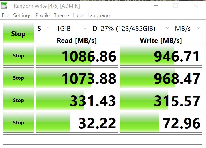

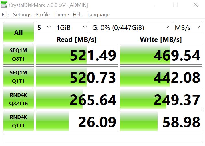

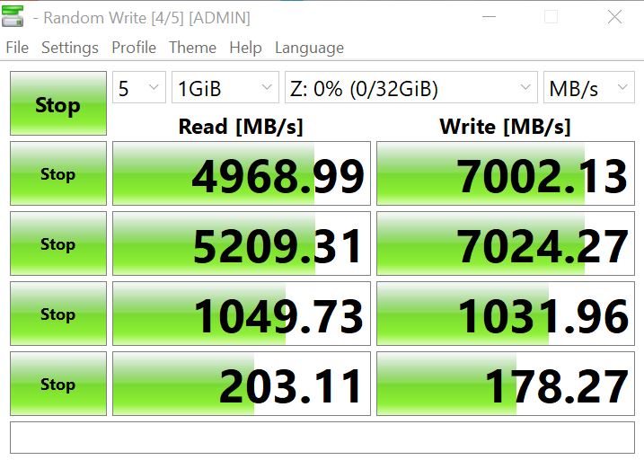

So, here we go this is what we got and will post the current setup stats as well so you can compare:
Sabrent 2TB Rocket Nvme PCIe 4.0 M.2 SSD gives:
My Samsung 840 Evo Pro in RAID0 (SATA6) using Intel RAID Controller gives:
My Intel P240W in RAID0 (SATA3) using INTEL RAID Controller gives (BTW not using the Marvell RAID Controller because it's dog slow in SATA6 even slower than using SATA3 INTEL):
My 32GB RamDrive gives:

What Ramdisk software and RAM are you using there when that benchmark was taken? Seems a little slow there.

AMD Ramdisk software, yeah I thought that now you've just mentioned it, however handy to have when processing MKV files etc. Mmm, I've just done fresh install of qwindows and it's now where it should be and was, amended the pictures!!! See above for new RAM speed!"
Nice! That's much closer to what I was expecting from a Ramdisk. Unless you had really cheaped out on the RAM back then, and really downclocked your CPU. :p
