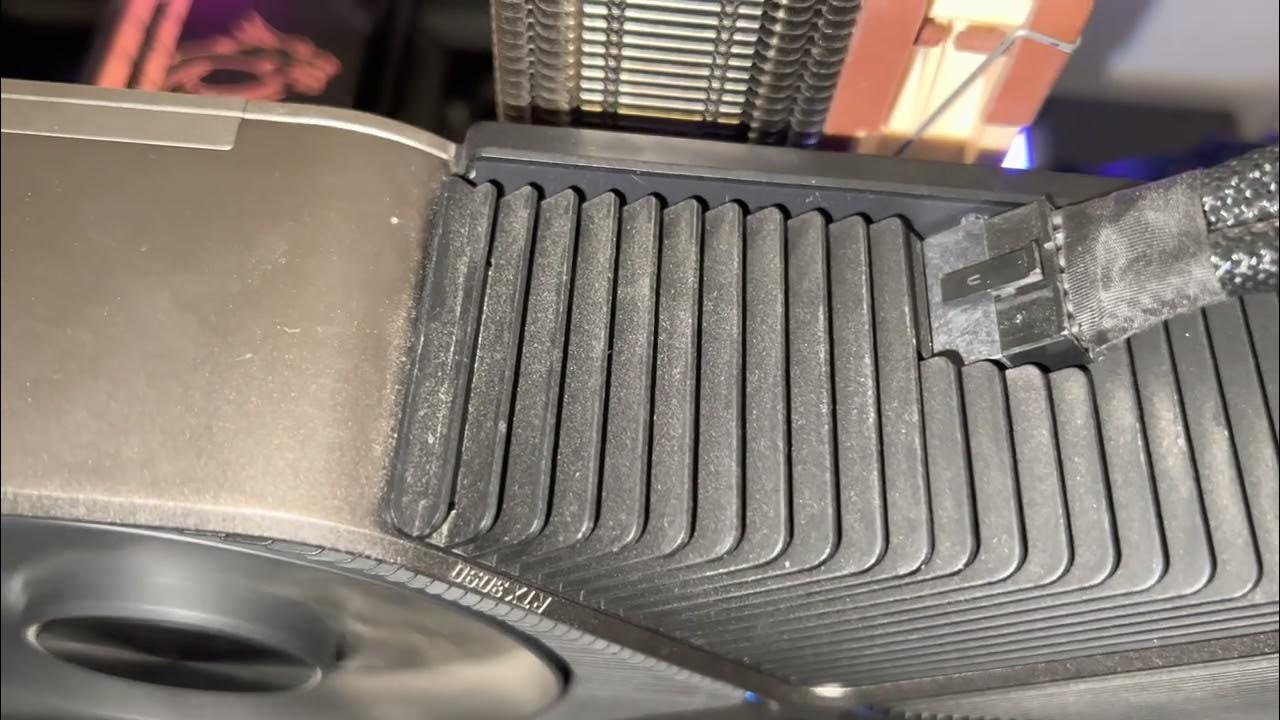

Replying from the watercooled case gallery. It's hard to tell on mine because the GPU has coil whine. So it either doesn't have any whine or it's being drowned out by the GPU. I haven't noticed anything out of the ordinary though.
Worst case scenario below. Running heaven at 400-700 fps.
Other setups for reference.
3090 Suprim + Corsair SF750
3090 FE + Seasonic Prime 1000W
