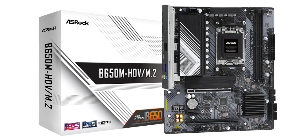

@Tetras Asrock B650M-HDV (micro-atx) is supposedly coming out in the US (I assume UK soon too) and it's meant to be hitting around $125 price range... it will obviously have less features than the higher tier 670 boards, but to be honest the branding and tier separation on am5 boards this time is atrocious.
