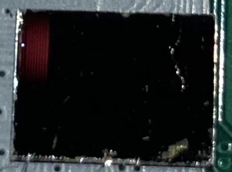

Do you mean the dark shiny coating? I could try to scrape it off.
Yup, on the supposed super-dooper-5G-blocking-IC -
Just thinking the bottom-right looks as if it's transparent underneath the coating and possibly showing some circuit. Top-left seems to show what appears to be an NFC RFID type antenna but i suspect it's the tracks of the PCB.
As someone else said, it's probably some e-waste flash drive/NAND reader type PCB that's been repurposed.

I dug out an old USB microscope webcam to get some closer pics which might help determine what exactly this is. Also scraped off the dark coating on the chip.
