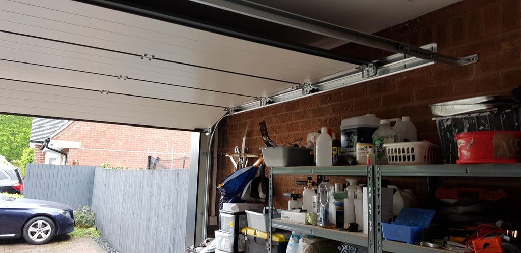

How does this work - how much room above do you need? my new build I had done has a low height so I can't really drop it i.e. a RR wouldn't fit in but a normal car would (my A6 does).

The limitation is height of the ceiling, the door can pretty much be constructed as tall as required. A RR would easily fit in my garage. The cross beam is at least 7 feet above the garage floor. These might help show the mechanism / ceiling construction:
Unsure about the side rolling question.

Better option would probably be a roller door that sits behind the lintel to give you maxium door opening. But even if you fitted the bulkhead within the door opening, you'd still have plenty of height to get an A6 in.
